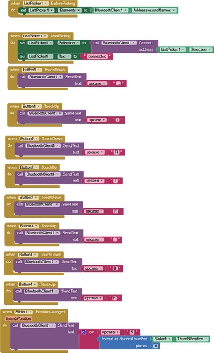

Hi. I control a robot via Bluetooth in app inventor. I have a problem.for example when I hold the forward button the servo rotates from position1 to position2 and then the servo rotation doesn't repeat again. I want the movement of the servo motor to repeat as long as I hold the button until I release the button. How can I do this? This is my code:

These are the blocks:
Why use predefined positions instead of incrementing a position by x many steps?
Initialize position to start at 0 and increase it by “step” each time you want to move. You can do the same in reverse too by subtracting step from position.
Just make sure you use the modulus operator (%) to not allow the position to exceed 360.
How can I do this? Can you suggest an example in code form?
maybe the device is not repeatedly sending a button code when the button is held down, it just sends it once for each press
So how should I design the blocks to send repeatedly?
