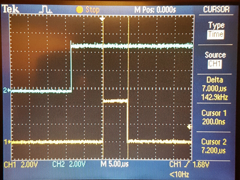

I was curious about this so I wrote a quick program for my Mega2560 to do what I think you need:
  • assumes K[0..3] are connected to PB[0..3] and A[0..3] are connected to PB[4..7] (all same port for quick direct port accesses)
  • K0 is connected to PB0 and serves as the interrupt input
  • every 250mS enable PCINT0
  • in the ISR:
    -- wait until the lower 4 bits (K[3..0]) show 0; at that point, save the contents of PORTB in array[0] and set a sync flag
    -- on each subsequent interrupt, store PORTB in array[1], array[2]...array[15]; on the 16th, disable the interrupt and set a flag for the mainline
  • when the mainline sees this flag, it prints the BCD contents of array[0..15]
  • repeat 250mS later
I tested it with pins driven high and low for A[3..0] and verified the correct values being printed.
I used timer 4 to generate a 5kHz 50% duty test signal to mimic a very rapidly switched K0 input. Assuming K[3..0] count from 0 to 16, each edge of K0 represents a tick of that "clock"; interrupting on each edge, sampling PORTB and then picking out A[3..0] after the fact.
Characterized the time spent in the ISR with time-consuming digitalWrite()s to a test pin. Scoped the output. I was actually quite impressed with the speed.
5kHz K0 rate:
ISR execution time <7uS
Even if the K0 clock rate was faster than this it looks like you'd have a decent amount of headroom.

I have since analyzed the firmware and find that three addresses are used in communication between the logic board and the 8279 on the display board in the original unit (it has been shifted to the I/O processor board in my redesign).
One address (specifically, bit 0) is used as a flag tied to the 8279's EIRQ pin to alert the logic there are key presses in the buffer.
Another address is merely used as a flag to force the A00 pin to read mode and fetch incoming key codes.
The last of the three addresses is the actual data port, and depending on the state of the A00 pin, is used to feed commands or display data to the 8279.
Seems something like this would be easy to implement in Arduino? I have a Nano and a serial LCD on hand.
Now that I can see how the 8279 is communicated with, I would like to see if and how I can get rid of the 8279 and stick the Nano in its place, and to use it to get rid of ten 7-segment displays, six LEDs, and their support ICs.
So, the nano would need these pins configured:
EIRQ - output
A00 - input
D0:D7 - data bus
8 pins for 4x4 keyboard matrix
I2C bus for LCD
