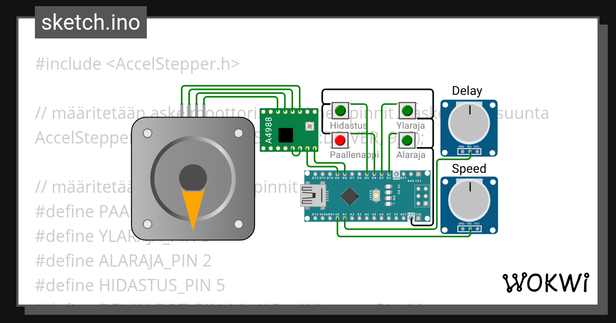

I implemented what I believe is your circuit
and I have a doubt: you use INPUT_PULLUP but are your switches (and buttons) connected to GND or to +5V ?
I mean:
if ((digitalRead(PAALLENAPPI_PIN) == 1)...
means PAALLENAPPI btn provides a 5V when pressed...

Yes. When you press the button, it will take about 5 v.
My question was about voltages, not timing. Is the button connected to ground (0V) or 5V ?
sorry for the google translator error :slight_smile: When you press the button, a voltage of about 5 volts is generated

pinMode(PAALLENAPPI_PIN, INPUT_PULLUP); is for buttons providing a Gnd contact. If your provides a 5V, that means an external pull-down resistor is connected to Gnd (4.7K or 10K probably) and you need to code it this way (to also remove ambiguity)
pinMode(PAALLENAPPI_PIN, INPUT);
or nothing at all for this pin as it is the default state anyway.
How are the 3 switches connected ? To Gnd or +5V ?
+5v or do you mean limit sensors? reed switches are of the pnp type, meaning that when the limit is reached, a voltage is applied. A pull-down resistor is connected to this, which drops the voltage to 5 volts. So I'm using 24 volts because I work in industrial automation and this is a voltage I'm familiar with...
Since all buttons and switches provide +5v, remove all the INPUT_PULLUP statements, they fight against the pull-down resistors.
And if you want to tinker with my Wokwi, you'll have to modify the buttons connection to reflect your contraption...
I hope it is a resistive voltage divider, not a simple pull-down resistor...
