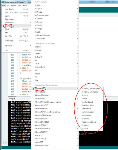

Your Uno is OK.
Then, you'll have to learn. As @alto777 suggested, read the examples provided by the stepper motor library you use (AccelStepper).
The other interesting readings you'll need to do (on top of basic "button read" and "pot read") are "Blink without delay" to know how to write non blocking code and some basics about State Machines (Finite-state machine is the real term, Äärellinen automaatti) to manage events in sequence.
