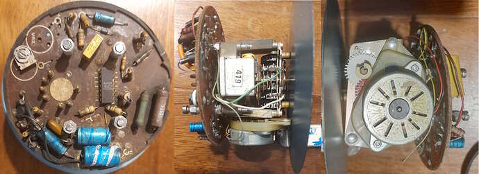

A friend has a heritage bus, but the speedo is broken. (photo)
the unit has an ammeter to show the speed, (you can see themoving coil above the "419" label)
and a 4 wire stepper motor to drive the mileometer.
Due to the age basically all the components are shot. Most of them are unidentifiable, especially the Plessey IC that I'm guessing is the stepper driver. No circuit diagram or component specs are available.
The bus HAS to have a working speedo & mileometer.
I'm wondering if its realistic to build a unit to drive the existing ammeter and stepper (so the unit retains its heritage appearance)
say with a nano or micro and a stepper driver.
and use the existing pulses from the sender unit to control the speed and mileage indication.
I know it would need to be calibrated, but I dont see that as a problem.
And the changes wouldnt show on an MOT.
I guess the main question is how to drive an unknown 4 wire stepper, so I'd start with that, and any advice on how to do so would be great - I've not worked with a stepper before.
Grateful for any help.

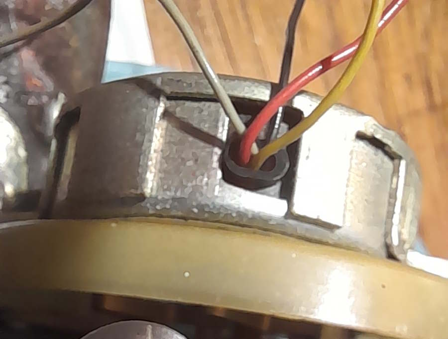

With 4 wires the stepper is probably uni-polar bi-polar. You could use a common H bridge driver after you figure out the motor specs.

its 150 ohm; and the wires (red, black, yellow and summick pale) red and black ae connected together on the pcb, so yellow and (whatever the other color is - I'm color blind!) are the driven ends.
Replacing the mechanical parts isnt an option as I'd have to re-engineer the whole system.
well I hadnt - and this takes me back to my schooldays (early '60s)
its a moving coil galvanometer - 75 ohms, 25mA full scale. But driving that isnt an issue.

You could use 4 Arduino pins and a ULN2003 to drive it, I think.
It looks grey in your photo.

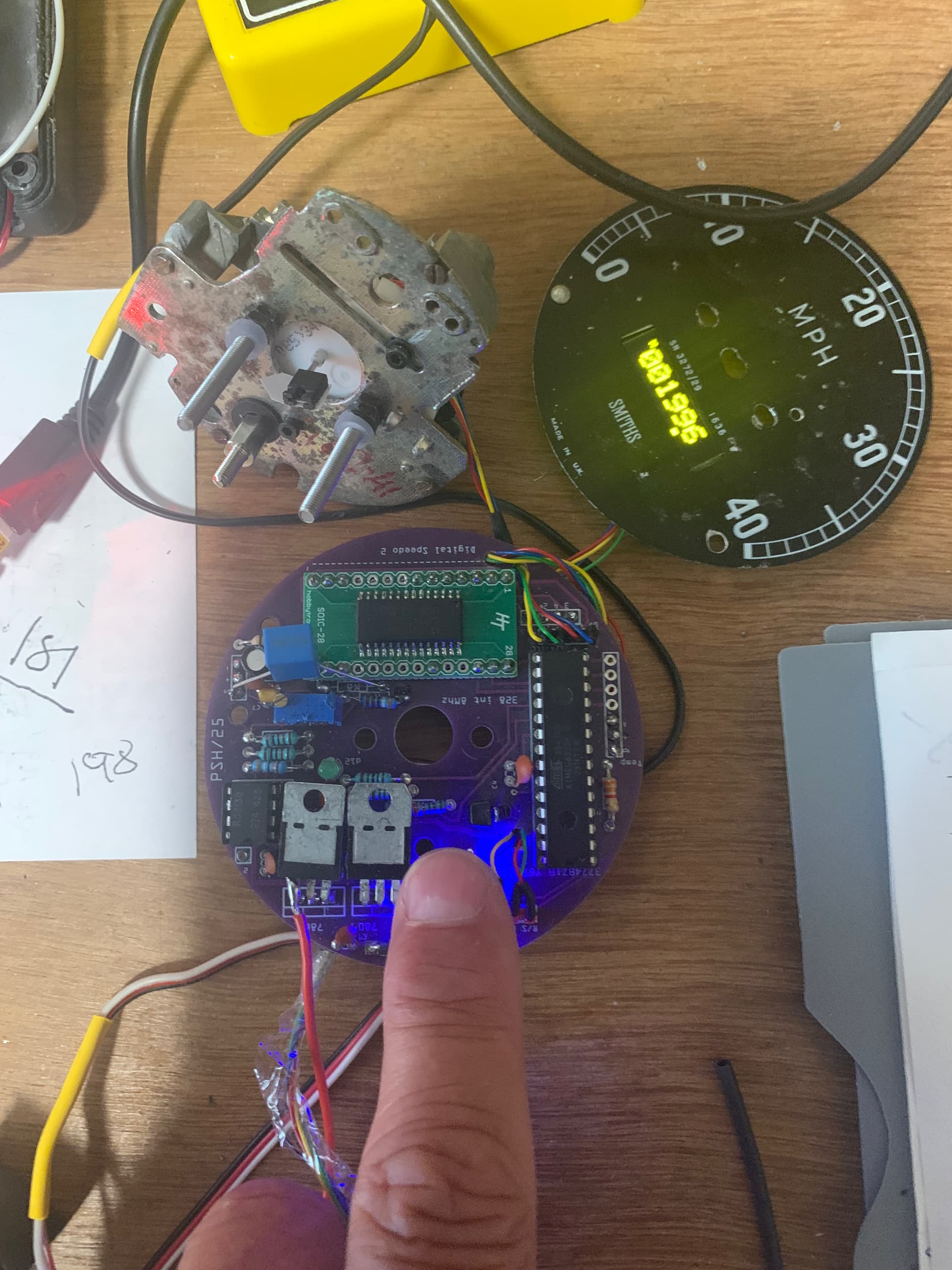

I’ve done a couple of these one using a gps module , one off a wheel sensor . In both cases I’ve used steppers to drive the pointer, but you can use your ammeter .
I would drive your ammeter off a voltage regulator ( say 12v) with the output , through a resistor , then your meter , then npn to ground .
Control the npn from a pwm output .
The resistor choosen to give max “mph” somewhere near max pwm (255) output .
Without the regulator changes in battery voltage will affect your readings .
The mileometer bit is harder , I cheated and just used an oled display . A lot use a mechanical rachet mechanism to move the mileometer , I could not find space to drive it .
The OLED has the advantage that I can have a trip meter and use the display to give warnings of water temp etc z
( small ‘m’ top left of the display indicating this is mileage not ‘t’ trip )

Have you tried replacing the electrolytic caps?
The one at the bottom looks really bad...

The mileometer mechanism looks re usable.
If you can work out the circuit , you might be able to get it working - eg replacing the Plessey chip with something that would do the job or even a like for like replacement
Since the nano can source or sink 40mA why cant I just drive the galvanometer (25mA full scale) directly by PWM from a digital output - with a series resistor?
I dont need more than 1% precision so I'm happy with 8 bit.
I'm replacing the caps and the burnt out 75 ohm 5W resistors as soon as the parts arrive. However tracing and reconstructing the circuit from new isnt an option. Most of the resistors are so discolored I cant read the color codes, and cant assume the current values are what they were when new.
And replacing the plessey chip - M1C1P - well it was likely a special.
Plessey "In 1989, it was taken over ..."
There are also two transistors that (as yet I'm guessing) drive the motor coils. I'm trying to identify them: if all else fails I'll just test whether they are pnp or npn. Then maybe i can copy that bit of the circuit to drive the coils.
There is no regulator on the board although there seem to be a few zeners.
You may ask why not just unsolder and measure. All the wire ends are bent over so removing each one involves a lot of heat, and the tracks ...
I'm also hampered by my old eyes, and have to rely on macro photos to see the fine detail like faded part numbers.
