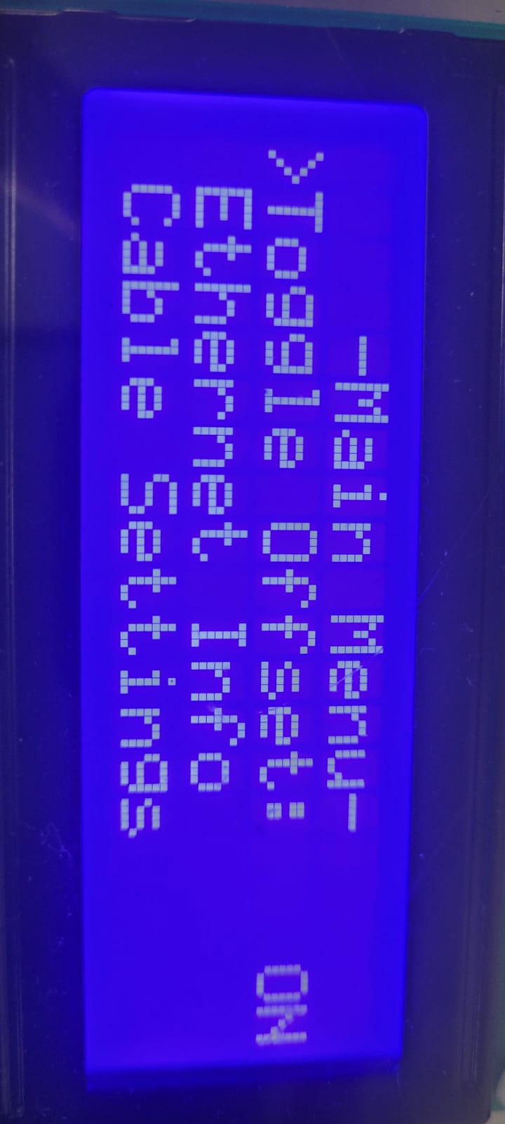

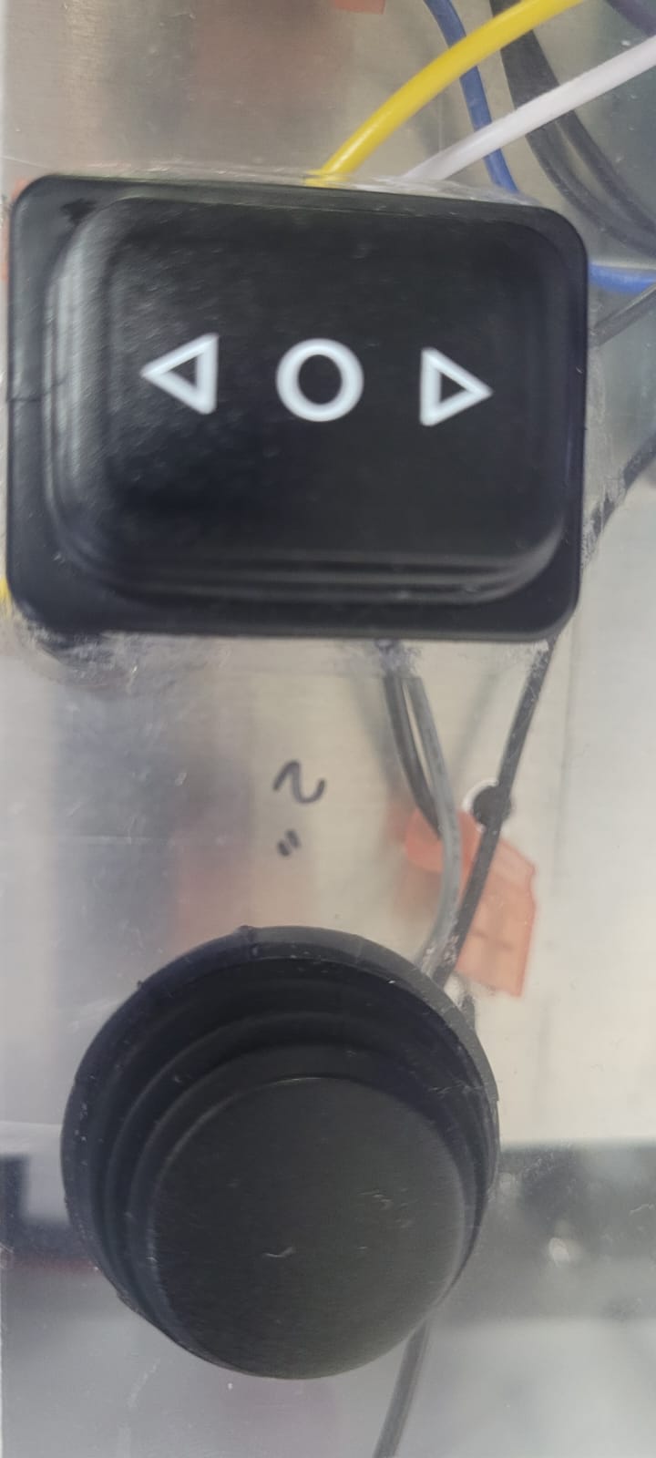

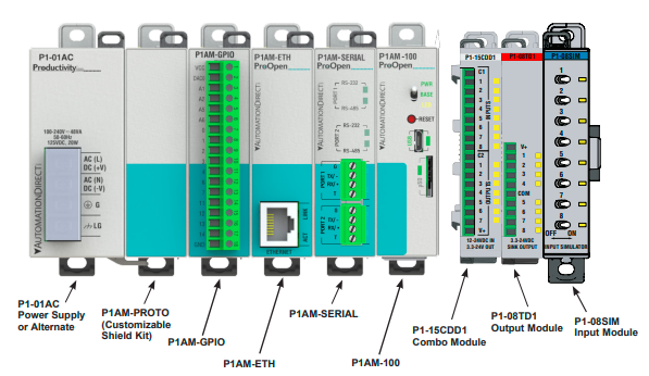

Hello, I am working on a network module to control a high-power VFD motor system. Until now, everything in the prototyping stage has worked, although I had to step away from the project for a year and a half. Now that I am implementing the first version of this device, I have encountered the problem of not being able to find a suitable rotary encoder at a fair price. Therefore, I am considering replacing the encoder with a 6-pin rocker switch. Given that the code is around 5000 lines and my peers are no longer involved in the project, it seems easier to adapt the rocker switch to perform the same function as the rotary encoder, which is simply scrolling through the menu.
If anyone has suggestions on how to adapt the code, that would be greatly appreciated. Currently, I am using the CLK pin for the RockerUp pin, the Data pin for the RockerDown pin, and I added an extra push button to simulate the select function. I also had to add some debouncing. At the moment, the code only scrolls in one direction (Up), but pressing the rocker down does not scroll in the opposite direction. I believe this is related to the CW and CCW logic in the code, specifically in the Rotate() function, but I am not entirely sure.
I couldn’t attach the entire code due to its length, but I've included some functions that relate to the CW and CCW logic, which I think might be causing the issue.

// Main menu *****************************************************************
void MainMenu() {
int menuLength = 6;
menuPosition = 1;
ESC = false;
clearScreen();
updateMenu = true;
while (!ESC) {
previousMenuPosition = menuPosition;
if (encoderCW) {
if (menuPosition >= menuLength) {
menuPosition = 1;
menuPosition++;
encoderCW = false;
updateMenu = true;
} else if (encoderCCW) {
if (menuPosition <= 1) {
menuPosition = menuLength;
menuPosition--;
encoderCCW = false;
updateMenu = true;
if ((previousMenuPosition == 4 && menuPosition == 3) || (previousMenuPosition == menuLength && menuPosition == 1) || (previousMenuPosition == 3 && menuPosition == 4) || (previousMenuPosition == 1 && menuPosition == menuLength)) {
refreshLCD = true; // Checking to see if the menu has scrolled
if (updateMenu) {
if (refreshLCD) {
clearScreen();
refreshLCD = false;
if (menuPosition < 4) {
setCursor(0x04);
Serial1.print("-Main Menu-");
setCursor(0x41);
Serial1.print("Toggle Offset:");
setCursor(0x40 + 17);
if (offsetActive) {
Serial1.print(" ON");
Serial1.print("OFF");
setCursor(0x15);
Serial1.print("Ethernet Info");
setCursor(0x55);
Serial1.print("Cable Settings");
} else if (menuPosition > 3) {
setCursor(0x01);
Serial1.print("Drum Settings");
setCursor(0x41);
Serial1.print("Set Units:");
setCursor(0x40 + 16);
if (metric) {
Serial1.print(" m");
} else if (imperial) {
Serial1.print("ft");
if (seconds) {
Serial1.print("/s");
} else if (minutes) {
Serial1.print("/m");
setCursor(0x15);
Serial1.print("NMEA Period: ");
LCDPrintSeconds(NMEAPeriod, 0x14);
DrawCursor();
updateMenu = false;

void SelectPressed() {
noInterrupts();
selectPressed = true;
interrupts();
void Rotate() {
unsigned long currentTime = millis();
// Logic for rockerUpPin (Clockwise)
if ((currentTime - lastDebounceTimeUp) > debounceDelay) {
int currentCLKUp = digitalRead(rockerUpPin);
if (currentCLKUp == HIGH && previousCLKUp == LOW) {
encoderCCW = true; // Clockwise rotation detected
previousCLKUp = currentCLKUp; // Update previous state
