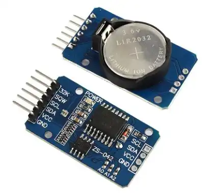

  • You are hereby promoted from newbie to pre-expert.
  • As a result you should look into how to use an RTC, suggest the DS3231.
got a warm fuzzy feeling...
:smiley:
thats what i was looking at
If you looking at that, you needa read this:
DS3231 battery issue

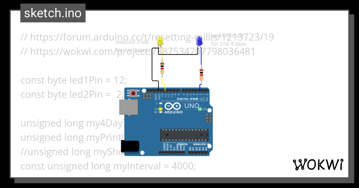

it's hard to tell what you're thinking
the if (currentMillis - startMillis <= period) has no braces which means the body of the if statement is just the next statement (line).
the next statement, without any braces is just
    if (currentDew > 11.5 && (currentDew < 12.5))
      ;  // Level to aim for dew point 12
which means neither of these if statements do anything
and then there's another
it's not clear how the code it tracking time/days
do you just want to do something once every 4 days?

so there's a lot of redundant code, at least display code that could probably be put into a sub-function.
seems that for each dewpoint setting the outputs are set one way when the dewpoint is below some target, another setting when above the target and a third setting when around the target.
seems like you just need a sub-function where you specify the target and then select one of 3 control settings
does this sound right?

So here is a demo-code. Full code posted below.
For explaining parts of the code are posted first.
The code is structured into multiple functions where each part of the code does
one thing
the functions have self-explaining names. This means these function-calls inside loop() give an overview about what the code is doing
The code simply prints to the serial monitor and switches on / off two LEDs where the LEDs represent / indicate
  • code part 1 executing first 4 days
  • code part 2 executing second 4 days
function loop()
  // check if 4 days of time have passed by
  if ( TimePeriodIsOver(my4DayTimer, myInterval) == true ) {
    // if REALLY 4 days of time have passed by
    flip_between_First_and_Second();
  // check if boolean variable with name "first4Days"  is true
  if (first4Days == true) {
    printFirst_4_days_message(); // does what the function name says
  // check if boolean variable with name "second4Days"  is true
  if (second4Days == true) {
    printSecond_4_days_message(); // does what the function name says
  printDaysPassedBy(); // does what the functions name says
WOKWI-Simulation
complete demo-code
// https://forum.arduino.cc/t/resetting-millis/1213723/19
