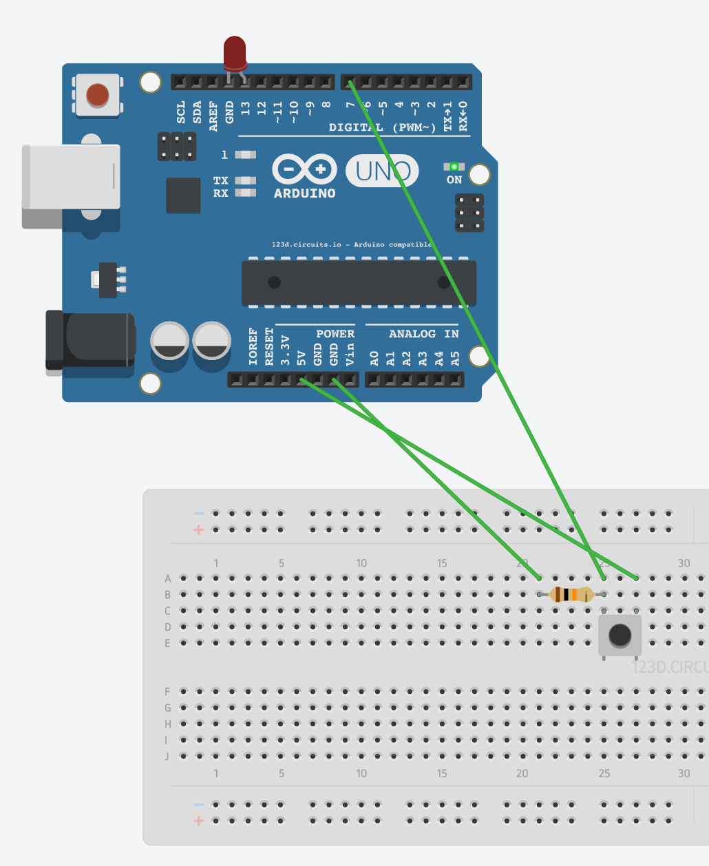

I'm doing a very simple beginner experiment. It's an LED in pin 13, a push-button on the breadboard. The circuit goes 5V -> switch 12 -> switch 22 -> pin 7 (INPUT) && [10k Resistor -> GND]
My question, is what is the function of the resistor? My guess originally is that it sends some current to pin7, otherwise it would all short to ground.
Why can't I send all the current to pin7 I noticed that when I removed the resistor and ground wire from the circuit and just went 5V -> switch -> pin7 the light is ALWAYS on even when the switch is open... can someone explain why this is?

Poor design copied from elsewhere no doubt.
Try this: button wired to connect 7 to Gnd when pressed.
Remove the LED, use the onboard LED that is driven from 13. At put a 270ohm resistor in series with the LED.

The pulldown resistor and connecting the pin to +5 when the switch is pressed is because beginners often think of a low pin as OFF and a high pin as ON; the 10K resistor bleeds off any voltage on the pin to hold it low when the switch is not connecting the pin to +5 when pressed.
In fact you can see how easy it is to think the other way: LOW is the active state, and HIGH is the inactive state.
Using the internal pullup also prevents miswires and shorting the 5V line to Gnd by accident and taking out the voltage regulator or causing other damage.
Basically if you have an input pin that is not connected to anything, its voltage could be anything
from 0 to 5V (for a 5V system).
This is called a floating input since CMOS circuitry takes effectively zero current (10^-12 A or
so in fact). A pull-up or pull-down resistor defines the voltage on the pin so it works reliably.
The ATmega microcontroller also has built-in pull-up resistors to save needing external resistors,
engaged by pinMode (pin, INPUT_PULLUP)
