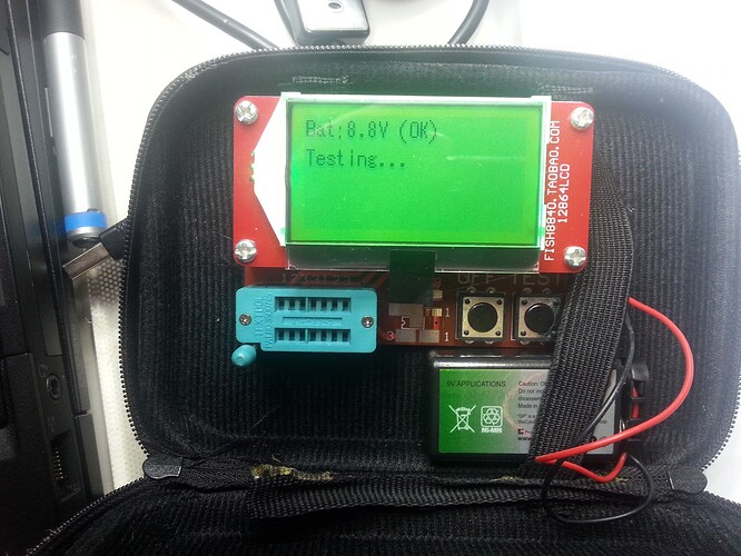

Actually I have bought one like this myself, and it is working great!
I might do a movie of this one that I bought.
However there are different between the types of this multi meters, some has more function that the others.
Also there is a MISTAKE in reading the BETA of Bi-polar transistors, I have checked few and they are mistaking in some of parameters.
So you need to make sure what you really want to measure with them
Attaching picture of mine

I bought this one and am most impressed. I thought it would be ideal for quick and dirty measurements but have been surprised by its performance. I can't buy the parts for that price.
Russell.
