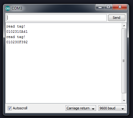

Hi there,
I have the book from Tom Igoe "RFID For Beginners" and am having trouble trying to get the code to read my RFID tag. When I pass the tag over the reader, I get some strange symbols rather than the code. The symbols are different depending on what tag I use, so I think it's reading the tags but maybe not displaying them correctly. Attached is a screenshot of what my serial monitor looks like when I pass two different RFID tags over the reader--as you can see I get different kinds of jumbled signals. I have an Arduino Uno, Arduino 1.0.1, an ID-12 RFID reader, and the RFID breakout board from Sparkfun.
In terms of wiring it up I have followed his instructions from the book.
- The 5V (pin 11) and RST (pin 2) pins are connected to power.
- The GND (pin 1) and FS (pin 7) pins to the ground line.
- And finally D0 (pin 9) is connected to Pin 6 on the Arduino since it's defined as the Rx pin.
Here's the code that I have. Originally in the book the startByte and endByte were 0x0A and 0x0D (for the Parallax reader), but in the book Programming for Interactivity, it says that the code for Parallax and ID-12 readers are similar except that ID-12 readers have start and stop values of 0x02 and 0x03, respectively. So I changed them.

Thanks in advance for any help you can give!
