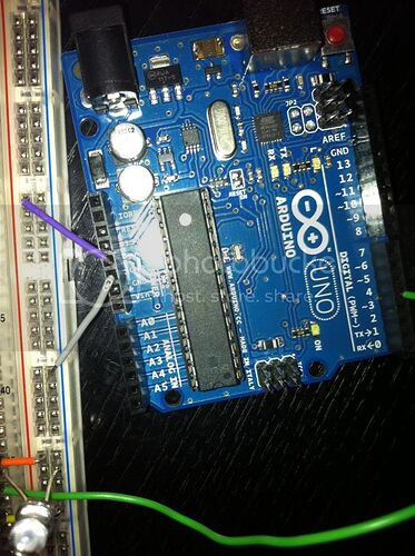

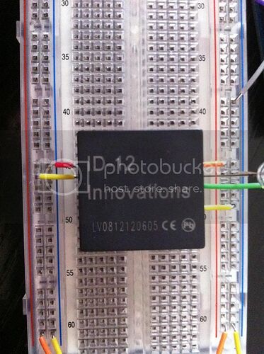

hello,
i recently got the ID -12 RFID tag reader.
now im trying to get it to work.
I found a bit of code that fits my needs online, however there is an issue.
Here is the code:

And here is the serial display when i scan an id tag
RFID Reader Initialized
Tag read: FFFFFFFFFF
Checksum: FF -- passed.
VALUE: ÿÿÿÿÿÿÿÿÿÿ
Tag not authorized
Whats going on here?
im a nooob, so i dont have the slightest idea whats going on!
