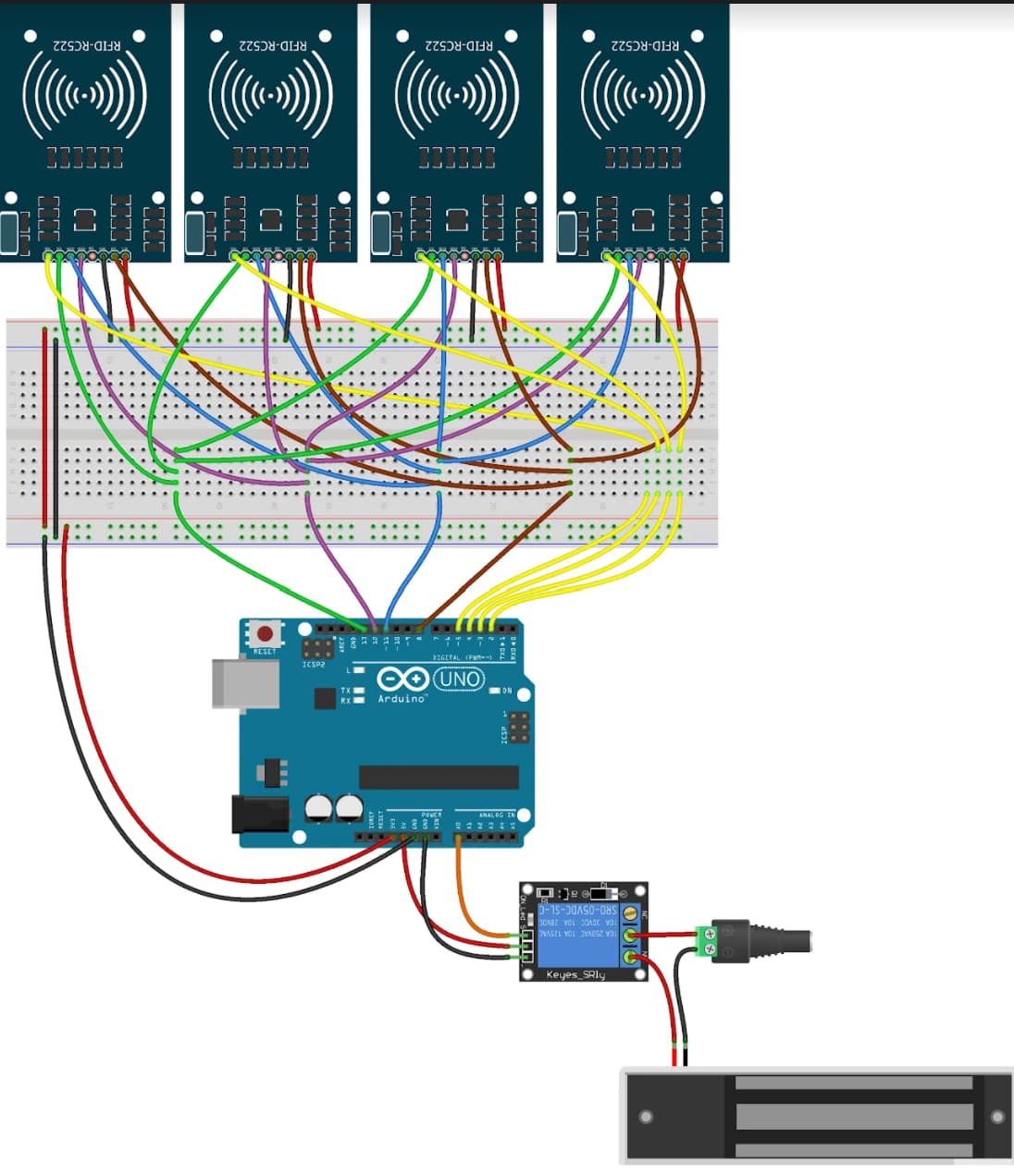

Here is the diagram I'm using. This is not my design. The differences in what I am doing as opposed to this diagram are that I am using a Nano, I only have one RFID sensor, and I am powering through the Vin and one of the GND pins. I have used a Nano for this at least 5 other times with up to 4 sensors, and it has always worked before. The current project also works as long as I am attached to a USB for power.
So it’s not your circuit…. Please draw your circuit on a piece of paper as it is (not a fritzing where you can’t see anything anyway)
