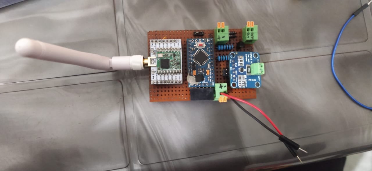

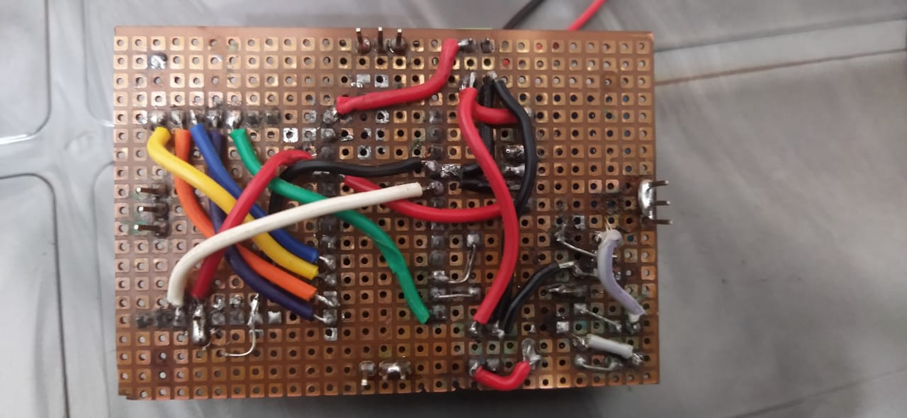

Hi!
I am working on a project where I interface a RFM95W (915MHz) transceiver to an Arduino Pro Mini 3.3V. I have removed the in-built voltage regulator on it and replaced it with MCP1702 (which has a 250mA max supply current). The regulator is powering the arduino, RFM95W and INA219. I am powering the setup with a 9V battery and using an INA219 to measure the battery voltage. DIO0 is connected to Pin 2 on the Promini (using the default pins).
This node communicates to a single channel gateway Dragino LG01-N (I am not using LoRaWAN. Just updating the data to a cloud via https). The gateway on receiving a packet from the node sends some data back to the node.
The node waits for the gateway and if the packet is received it goes to sleep for ā€˜x’ minutes (as set from the cloud) after which it again wakes up and re-transmits the data. If it does not receive any data from the gateway then it waits for 20secs and then goes to sleep for 1min.
For the node, I am using a 824-960-mhz-1710-2170-mhz-2-3-dbi-magetic-mount-antenna connected to the RFM95W via an SMA connector and a 3m long coaxial cable.
The problem:
Now, this setup is running great at first (the RSSI of the received packet is a bit weak, -50 to -70 @ 1m distance from the gateway). However, the problem occurs after I leave the node to run for more than 15-16hrs continuously. The node suddenly stops receiving data from the gateway. It transmits just fine though (the gateway is able to receive). But it will not receive any data.
After I checked the "dio0 pin of the RFM95W module, I found out that it is always HIGH and when I check it with a multimeter (on continuity test mode), it shows a short to Vcc of the same module.
Does this mean that the module gets damaged somehow while running? Is there a way to fix this? This has happened twice with the same circuit. The last reported battery voltage seems to be 8.7V before the node stops receiving, so the battery does not seem to be the issue here.
The antenna could be the problem here but I’m not sure.
Here is the code for the arduino pro mini 3.3V:

Show us a picture of it all wired up ?
Top view
Bottom view

I have checked the circuit for any shorts or wrong connections quite a few times. Maybe I am overlookng something obvious here but at the moment I can't think of anything other than a faulty MCP1702. @srnet What do you think? Or do you have anything specific in mind that I should check about the connections?
