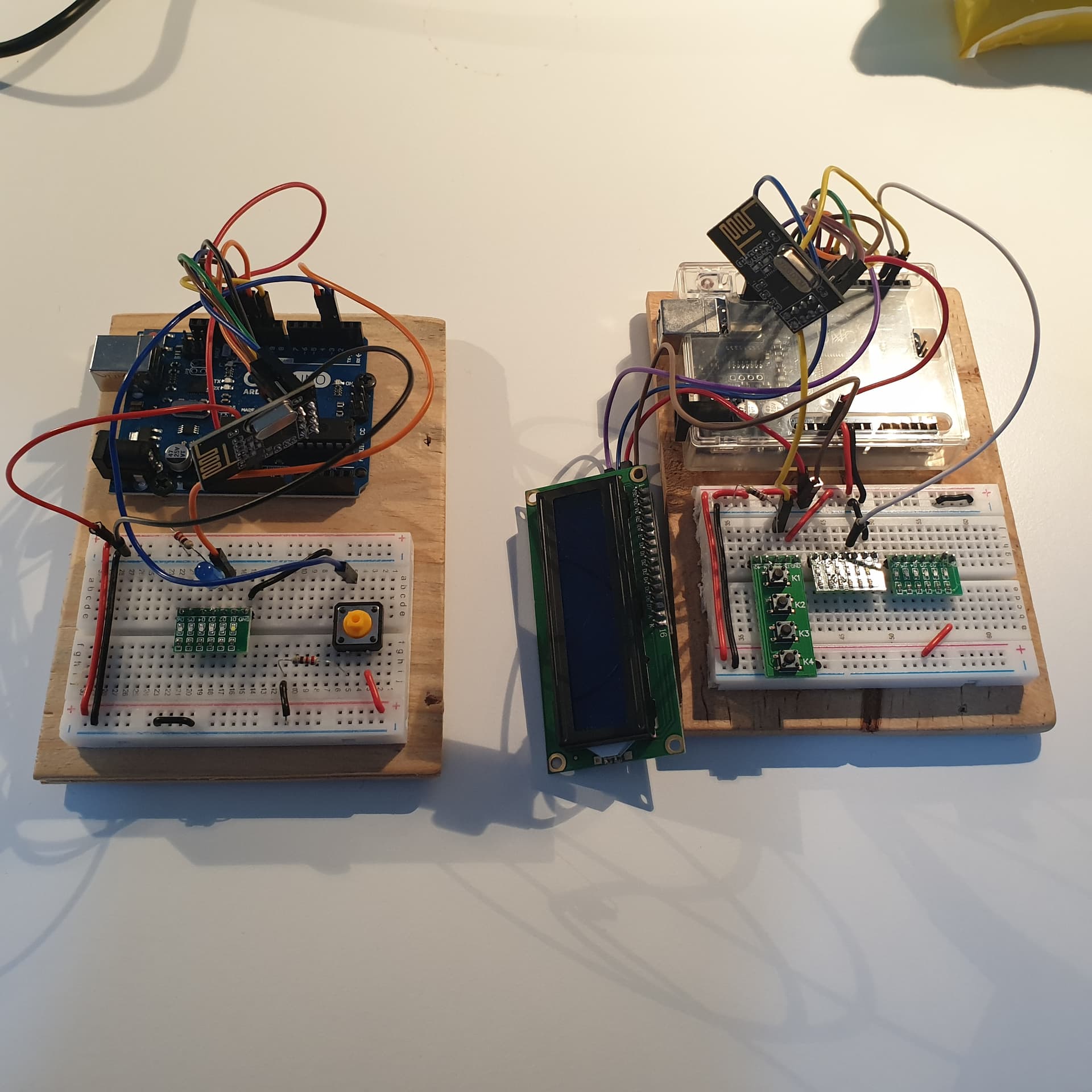

The project is a home-made version of a BlazePod. In brief, a master unit sends commands to slave units, which then light up. The units respond with the number of ms they were lit up for before they were 'hit'.
I'm in the early stages of development: I've got as far as a master/slave pair that perform this basic functionality using an UNO, and an nRF24.
Master code.
Slave code.
That's great, so far... it all works over a range of at least 20m, which is more than far enough.

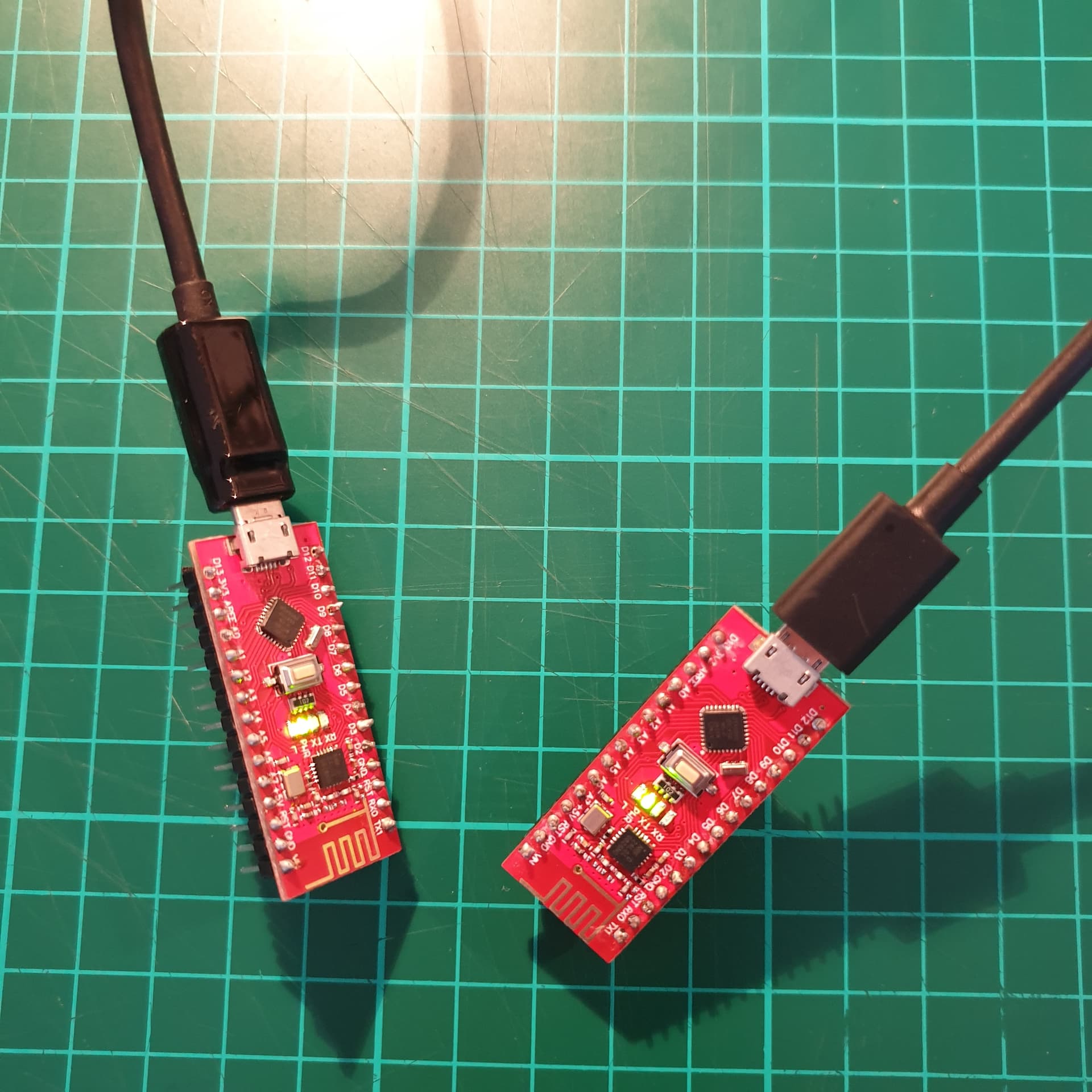

However, now I'm thinking of moving into a more suitable form-factor, I've switched to something that was sold as being similar to an rf-nano:
(it says 'TSTAR TECH') on the bottom.
With this unit, the range has dropped to roughly an arms length.

So these 'new' modules have a range thats only about 1/20th of the more normal NRF24 module, using the same code ?
If the 'new' modules had been mine, I would bin them.
Thanks. It does seem to be the modules that are the fault, doesn't it? Once they're in the bin, what would you do? Would you try a different 'rfnano' from a different supplier?
Or, does the rfnano just not have as good a range as the 'seperate arduino and NRF24 module' solution?
Both devices use (or at least pretend to) the same RF device.
So whilst you might expect a 3dB or a maybe a little more difference in actual radiated signal due to differences in design of the component layout and PCB antenna, your reporting maybe 25dB difference, which just does not sound right to me.

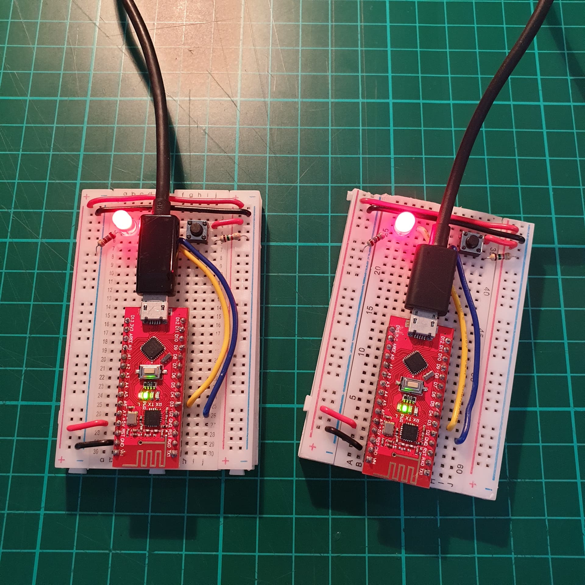

I'm just guessing here. Is there something positioned next to the antenna that should be moved away from it?
Like an oversized button and pieces of wire? :grin:
And - a breadboard with embedded metal strips! :roll_eyes:
Great point. I've switched to a much smaller button and moved it to the other end of the breadboard, like this:
There was no improvement, but great suggestion.

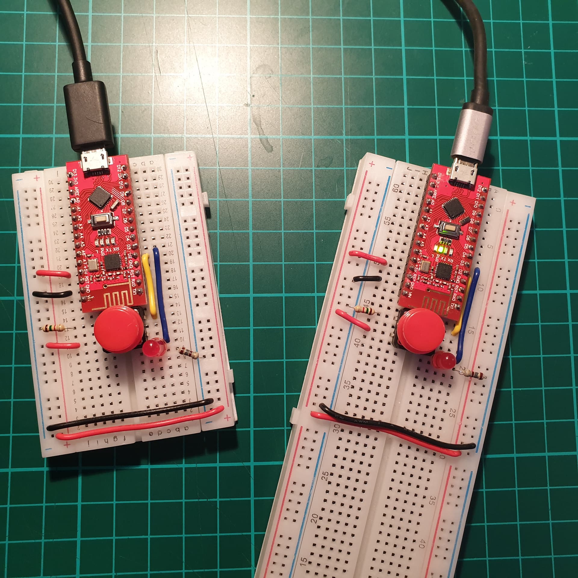

Again, somehow I didn't think of this. :man_facepalming: So... let's get rid of the breadboard entirely:
The range did not improve by any noticeable amount.

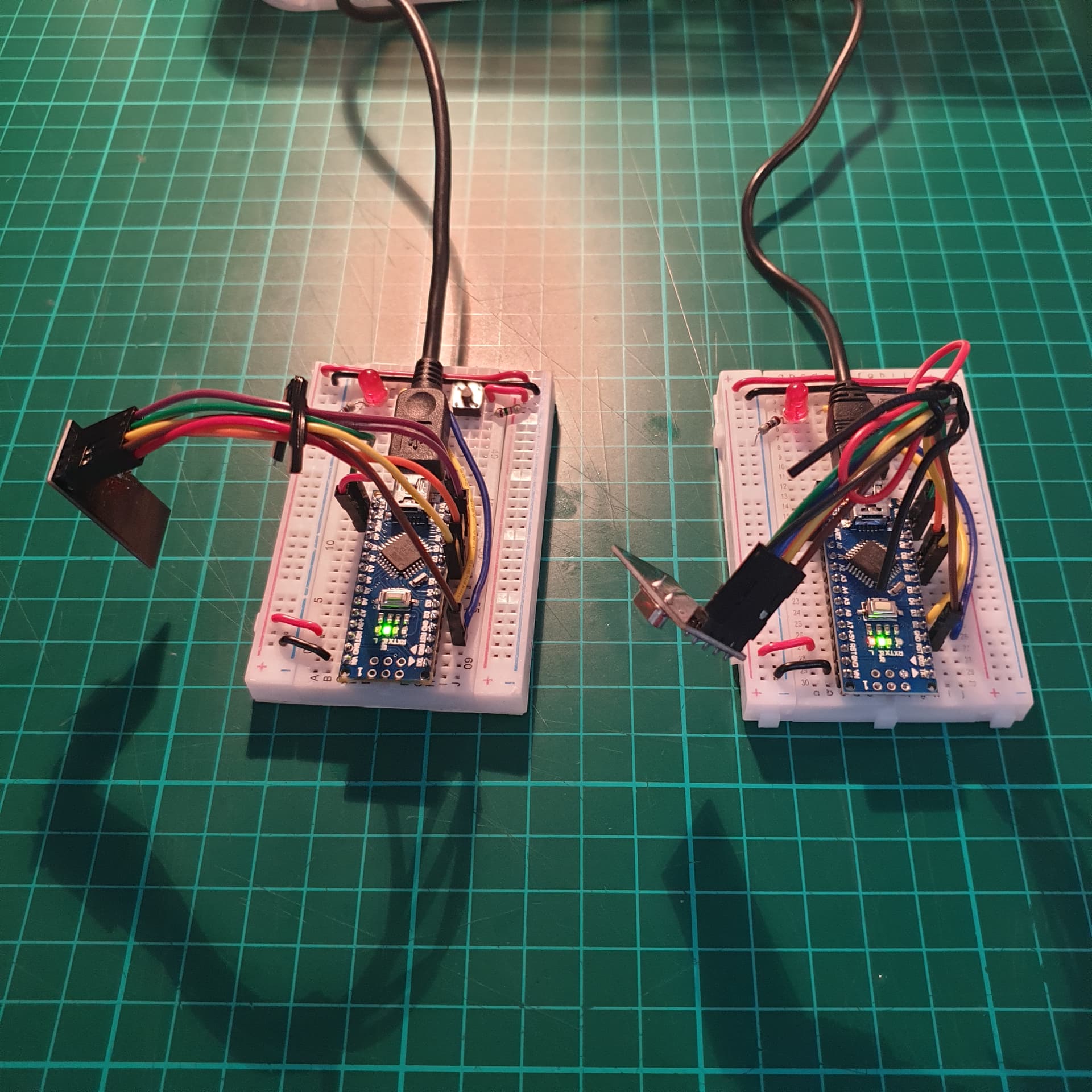

Another small update:
I've built something quite similar to the original set-up, but using Nano instead of Uno. Great range. So... If the new RFNanos (when they arrive) are just as bad as the 'TSTAR TECH' ones, I've got a fallback option.
