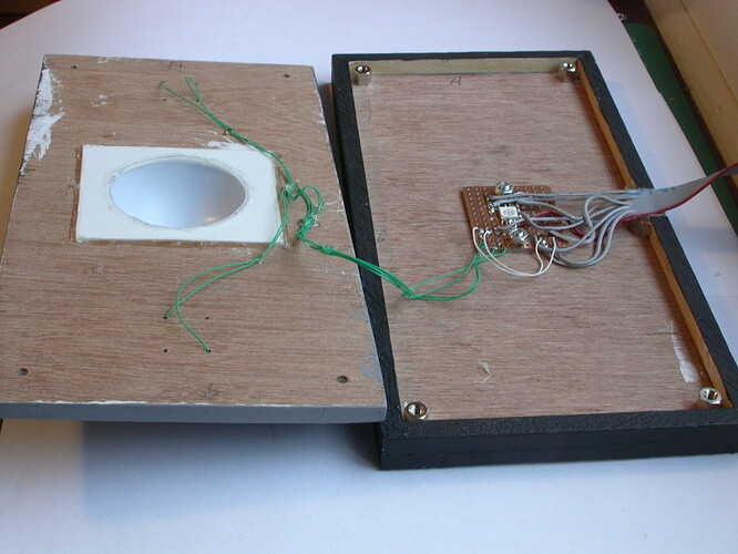

Another favourite solution is to drill a 5mm hole in a ping-pong (table tennis) ball and insert the led into that.

PaulRB:
Here is one I made earlier:-

Mike, it almost looks a bit naughty for some reason.
Not sure why.
It is a colour snap game from:-
