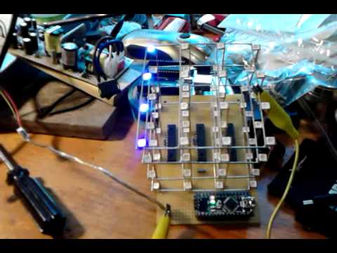

Im trying out TLC5940 chip on the SMT RGB LED cube, I have it wired up with 3 Chips, each have a 2k resistor, and I used 1 10k resistor, but the schematic didnt show any decoupling caps, so I didnt put any in.
Im trying it with the BasicUSe example software (just one plane of of 16 RGB LEDs, no multiplexing), and on Usb, it starts out really bright all on full, and after about a minute, it dims, and flickers each individual LED, but looks weird, and im pretty sure, wrong.
When I run it from 5v power supply, its similar to on USB, but its not bright at all, just flickering each individual led.
I know that I have some solder issues, since all the LEDs are not working (I buggered them up while soldering the wiring on the backside of the board.
Im using the info at:
http://playground.arduino.cc/Learning/TLC5940
and I wired it up like the example.
Heres a picture of the wiring, I havnt done the stuff for the planes, but I run a wire from the 5v to one of the common plane wires.
I worked on this again tonight. I repaired the some wiring on the middle chip, now all the LEDs light up in order, but they are pretty dim. I also put .1uf caps on each 5940, and its a little brighter, but nowhere near as bright as they should be.
Im just running one plane at a time with a 5v wire to the plane, and the software running the 5940s. The cubes gotten kinda beaten up being knocked around my bench for the last month or two. I will need to replace some LEDs I think :frowning:

I re-uploaded a new sketch, and hooked it up again, and its doing something! :smiley:
Right now I am only controlling one plane by connecting it to 5v.
The ICs are wired up like the example in the TLC5940 tutorial:
except that I have decoupling caps on each chip.
Its running the Useprogmem example program, it just lights all 16 RGB LEDs in a plane, and turns them off in sequence. I think it may do some PWM while its turning it off too.
Its not as bright as I had hoped, but maybe with some experimentation, i can make some improvements. I ran the same LEDs on shift registers and resistors, and I seem to remember them being considerably brighter, but maybe that just my imagination.

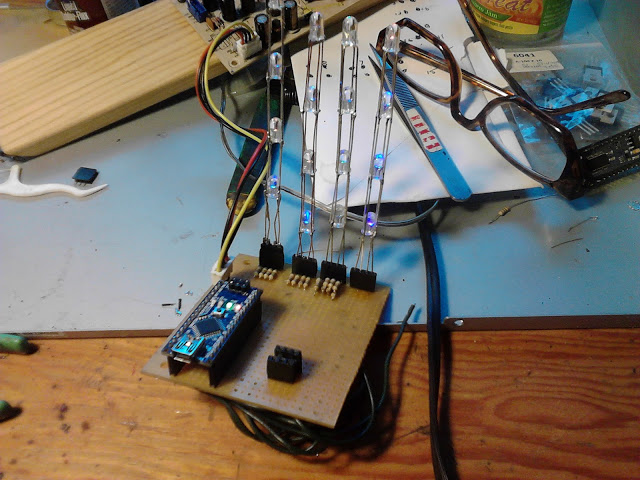

Yet another crazy cube idea. one of the nice things about this setup is that you dont use too much current, and you dont have to worry about mosfets, It does require more parts than the charliecube, but its only 16 transistors. Because it only lights up 12 LEDs at a time it only uses 240 mA, but it has a duty cycle of 4%, so it wont be very bright.
Here my modification of a 5x5x5 transistor cube (thanks crossroads), that I changed to 4x4x4 RGB. I didnt quite draw all the lines in, but hopefully enough is there to get the right idea.
