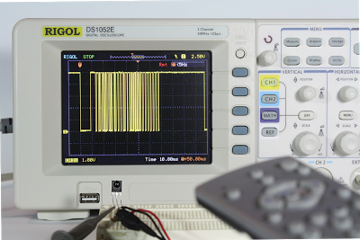

I have done this on a Rigol DS1052E in Python.
Ken Shirriff - he of the IR library has some examples on his web site :-

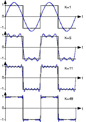

If you are looking at a 20MHz -digital- signal, it is helpful to have a scope that has an analog bandwidth about 10x that. Because a square wave at 20MHz is made up of increasingly smaller odd harmonics, and it takes up to about the 9th to get a reasonable looking square wave.
But that is if you are looking for problems in that 20MHz square wave. Ringing, slow rise time, that sort of thing. If you are only thinking that your Arduino can use a clock up to 20MHz and you'll be looking at signals from the Arduino, that 100MHz analog bandwidth should be fine.

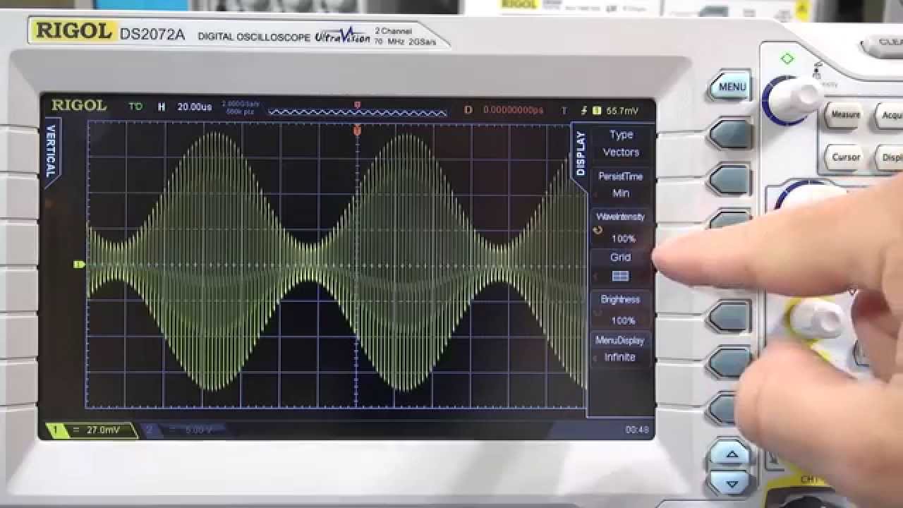

As for analog noise on the most sensitive setting, Dave Jones of EEVBlog does a great video demonstrating that it isn't really more noisy than an analog scope, it is just better at showing the noise.

Note that using up to the 5th harmonic looks pretty bad. Even up to the 11th harmonic looks messy.

@polymorph: yeah, for now I'm not going for morphological feature analysis of the wave. just debugging line outs :wink: for what I need even 5 harmonics is ok (looking at your scheme)
