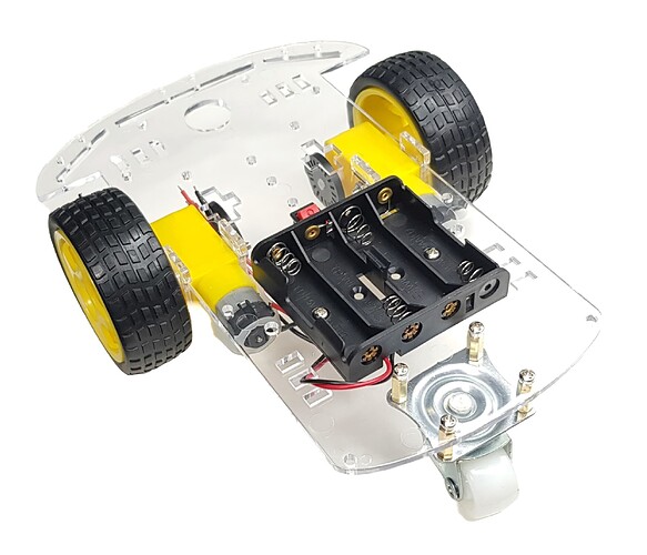

Use two front wheels and a round knob for the back "wheel" (or use a castor wheel). This is how to drive two DC wheel motors to do the eight major movements:

Yes... two motors and a castor. That picture does not have the circuit boards or other devices.
I think I may use a ball caster, but the way i power the wheel is just tank movement? power one side to turn in the opposite direction?
Yes. Just like a "tank" two-stick operation, each wheel has three options: Forward. Idle. Reverse. Using two wheels, you have 2 wheels * 3 Direction Options = 6 drive options. The grid is shown and described in post #6. Then you can have ENA/ENB (enable) connected to a PWM pin which allows variable speed of each of your six drive option.
