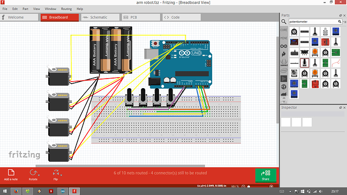

Hello guys, I tried to make a robotic arm from meArm with sg90 servos. First, I try to modified a code from arduino app called "knob" to control 4 servos at the same time. But, when everything wired perfectly, the servo goes wild. I've read another forum which said I have to add another external power supply for the servo, I've done that, but the servo still goes wild. Any solution?
Thanks
this is the code

Post your code, post your schematic.
AWOL:
I just add the code, thanks
So now just add your schematic.
The two are linked. It is a waste of time just posting one.
Edit :- read up on how to use more than one servo. Each require its own name.

I just add the schematic but it's not very good because i'm a beginner:) thanks

I don't see a common ground in your diagram. The servo -ve, battery -ve and Arduino Gnd must all be joined together.
JimboZA:
it's working!!! thanks!! but when I plug 4 servos with 4AA batteries power supply the servo didn't move. what can I do?
Perhaps the 4x servos together are calling for too much current.
JimboZA:
so I just add more batteries?
You could give each servo a battery pack yep, or perhaps one pack between two.
But just to clarify, individual servos do work?
It is best to post your layout diagram and your code again to make sure you are doing things correctly.

At first I tried to control 2 servos, it works with a little vibrate. And then, I tried to control 4 servos and it didn't work. Any solution for the vibration? thank you so much
That kind of vibration is often power related. You didn't say if each servo works correctly on its own? If they do, but then a bit of a problem with 2 and doesn't work with 4, it's likely you don't have enough current.
If that's the case you need more current from the battery pack or a battery pack per servo. Most people on the forum reckon on a 1A per servo budget (edit: although that's probably too generous for micro servos with little load.... I should measure mine)
Do you test with the servos mounted on the robotic arm? In this case they can influence each other by mechanical feedback, the only solution then are stepper motors.
