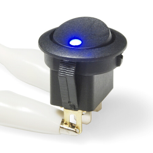

I got this SPST on-off rocker switch for a project I'm building...
My current set up:
I have 5V power going into the outer silver lead, the middle silver lead going to a bread board supplying power to 26 leds, and the gold lead going to ground. Everything works as it should when I toggle between the two position on the switch (leds toggle on and off)...
I would like to add some more functionality to the switch, by making it set a boolean in my Arduino sketch...
Does anyone have any advice on how to wire this switch to accomplish this task? Do I need to get a relay or can I accomplish this with the switch alone?
To tell the Arduino your LEDs are on you can simply take that LED supply out to an Arduino digital input via a large current limiting resistor (say 10k). You can read that value via digitalRead() or read it as an interrupt. That pin will also need a pulldown resistor to force a default 0 value.
Cheers! Geoff
Thanks strykeroz...this approach seems much simpler than the direction I was heading...
So I take the power supply from my 26 leds pass it through a 10 k resister and send it to a digital pin (32) which I read using digitalRead()...
I think I understand the theory of a pull down resistor, but am not sure how to wire it.
Do I attach digital pin (32) to another 10 k resistor that is connected to ground?
