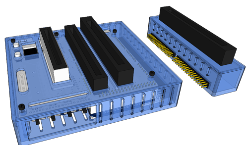

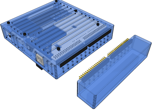

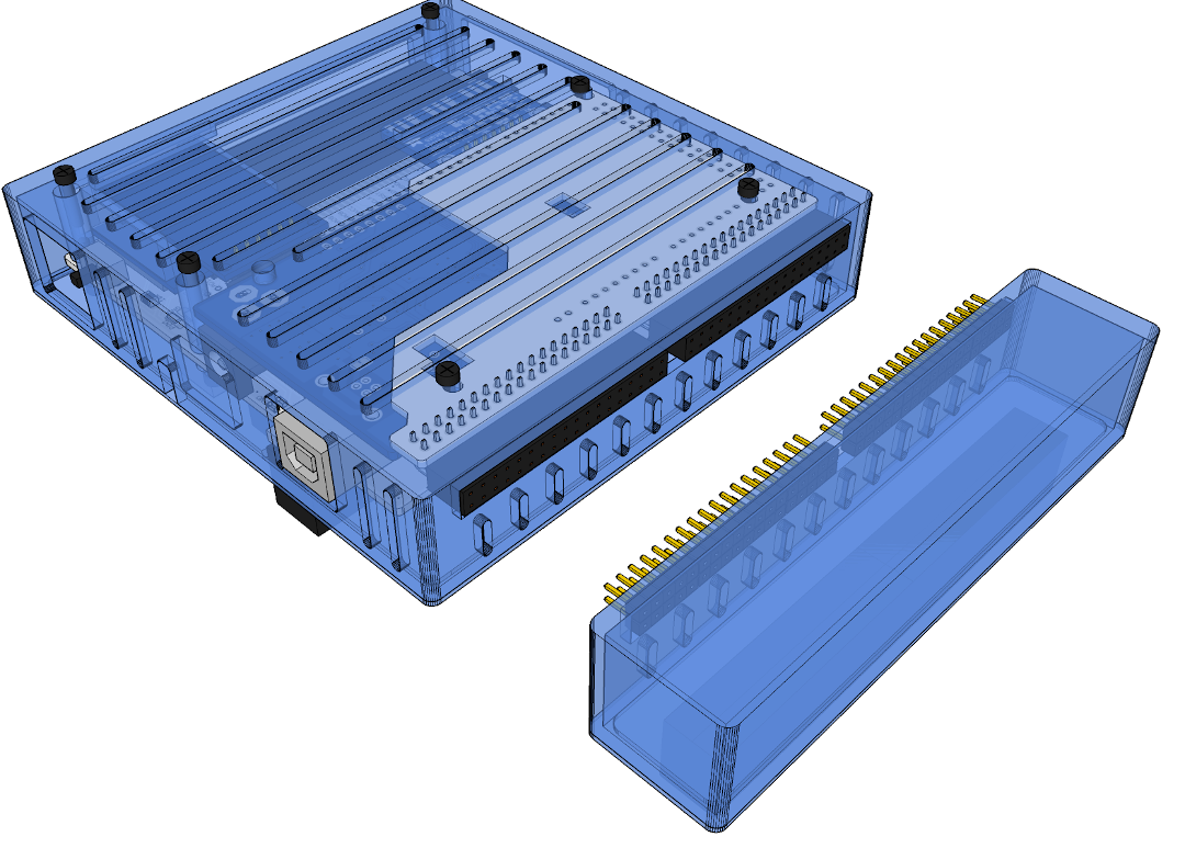

And finally, I thought of an alternative to the cartridge adapters: An expansion port.
It's a little PCB that gets soldered to the underside of the Arduino and that duplicates all its ports so you can plug-in expansion modules.
Not sure if I should pursue this idea though since it looks complicated. :sweat_smile:

sanni, my concern with this design is that it doesn't account for the battery module.
sanni:
Have you considered creating a new design that is more modular? For example, one PCB for the aduino and interface (buttons, SD, screen, power, etc) and then another PCB with the connectors (SNES, N64, GBA, etc)? Or didn't you have an older revision that worked that way?
Regardless, this is still super cool and I'm excited to update mine.
Well, let's say I thought about thinking about it. :grinning:
My current idea is adding a co-processor because the Arduino is getting a little outdated but at the same time completely replacing it would need way too much work adjusting timings and stuff.
An ESP-12 module can be bought for just $1.50 and would not only lend the Cart Reader additional processing power when needed, mainly for calculating checksums, but it would also add WiFi capabilities.
But yeah, that's also just an idea.
Are there concerns about the Mega getting discontinued or replaced at all? It seems like it has been around forever and I've always wondered if they would ever "retire" it.
I don't think the ATMEGA2560 is going anywhere any time soon with how many Chinese clones there are. There's even a relatively new formfactor for the Arduino Mega that uses the same CPU on a board with a smaller footprint.
Digikey has over 100,000 Atmega2560 chips available, that can make a ton of boards.
