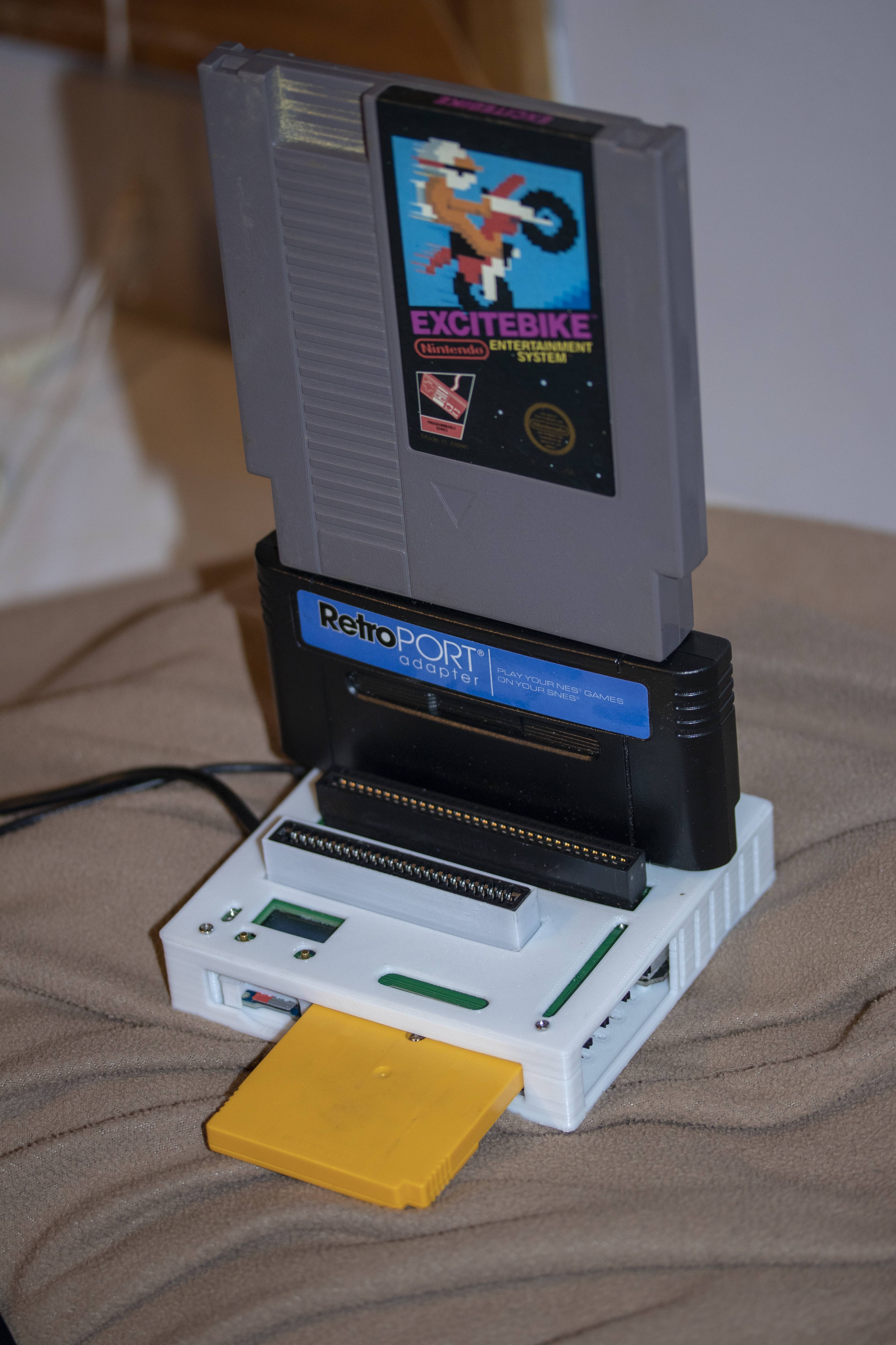

I bought one of these a while ago. Ended up getting 10 classic nes games in the mail today and it occurred to me that I could probably dump them with the retro port adapter and the cart reader. Anyone else tried this? I'd try it but it's buried in an unlabeled box somewhere in the closet.
EDIT.
Well, I went digging. Gave it a try and either I'm not doing it right or it doesn't work.
Is it the iNES Mapper I'm looking for to dump it?
You can't use such an adapter since it will have a completely different pinout than the adapter I designed and most likely will not expose all the NES pins to the SNES.
It's probably just an NES-on-a-chip design that only gets power and controller inputs from the SNES slot.
sanni:
I figured that might be the case. So is it the iNES Mapper code you want to grab from the database (if you have a correct PCB)?
