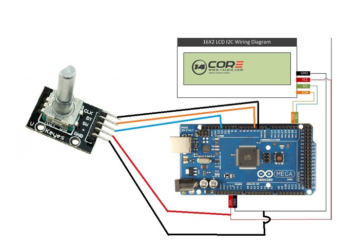

I need some help with a code for brewery controller that i found on the internet. A video of it can be seen here Arduino Brewery Controller - YouTube
I have connected the LCD and the rotary encoder but it do not work. I have tried to monitor the serial while turning the knob but there is nothing. I am not very experienced in using Arduino.
I first tried to use it on a UNO board but got an error. I then changed to am Mega 2560.
I have tried the rotary encoder with a basic code and it worked. The pins are correct.
I appriciate all help on this.
Link to the code GitHub - rkeithryan/Arduino-Brewery-Controller
"I have removed the code from the post"
Welcome to the forums. Please read the sticky post at the beginning of the forum about how to post your code using code tags. It helps people help you.
As for your code, you should try using the Encoder library rather than doing it yourself. It is much easier. It also looks like you did not post all your code as it cuts off mid loop()....
This encoder library may help to simplify your code.

The schematic picture is underneath. I have not yet attached sensors and rely since I wanted to test the code with just the LCD and the rotary encoder. The LCD is 20X4 IC2
Here we go!
Paul__B:
Here we go!
Thank you :slight_smile:
I have tried to change the pins to 8 and 9 and it is still the same. I forgot that LCD is using the 0-7 pins.
The setup of the code is very good except for the rotary encoder part, so I do not want to rewrite it.
My assumption is that the creater of this code uses a 16x2 LCD and I use a 20X4 LCD and some of the pins on the LCD is in conflict with the code.
I cannot find which pins are in conflict.
I am not sure if someone is up for the task to edit the code so that it works for me :grinning:
