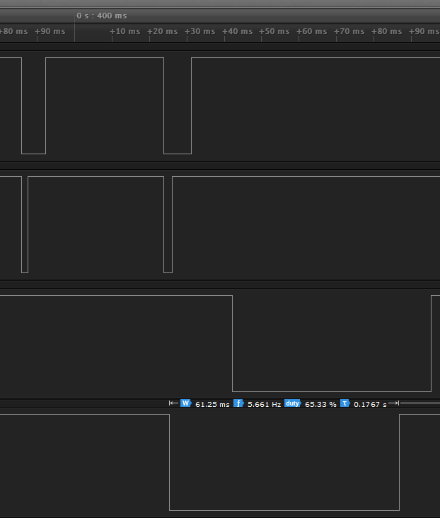

I have bought a bunch of encoders to use in my projects but they seem to behave in an unusual way (for me at least)
I made a screenshot of my logic analyser showing the anomaly.
The first two channels show the encoder in question the other two showing another encoder pruducing right gray code. (how i think it should be)
I tried two if the same encoder to be sure but both shows the same problem.
I don't have a real datasheet for them either.
Is this not a "normal" quadratic encoder? Maybe i wired it up the wrong way?
The pulse on channel 2 is really short too like 5 ms.
Have anyone seen something like this?

If you have an analog scope, then look at the waveforms. It might be something weird like a capacitor in the output.
I would suggest that it's broken and you should try another one.

Well, i tried 3 encoders now and i get the same result. Unfortunately i don't have an oscilloscope and neither have access to one. :confused:
One thing i forgot to mention is that the falling edges are perfectly aligned! If i turn the encoder in the other direction then the rising edges get aligned. I can not measure any difference at the highest resolution. It seems like the other half of channel 2 is cut off at start or end of channel 1s periods.
All the encoders have the same fault? They are from a somewhat reputable source and sold out now.
Do you have a spec for the encoders? And a circuit diagram?

Well this is embarrassing but... Yes I WIRED IT UP WRONG. The common pin was not the one in the middle. If i learned something today, always look at the datasheet and if you don't have one, get one.
