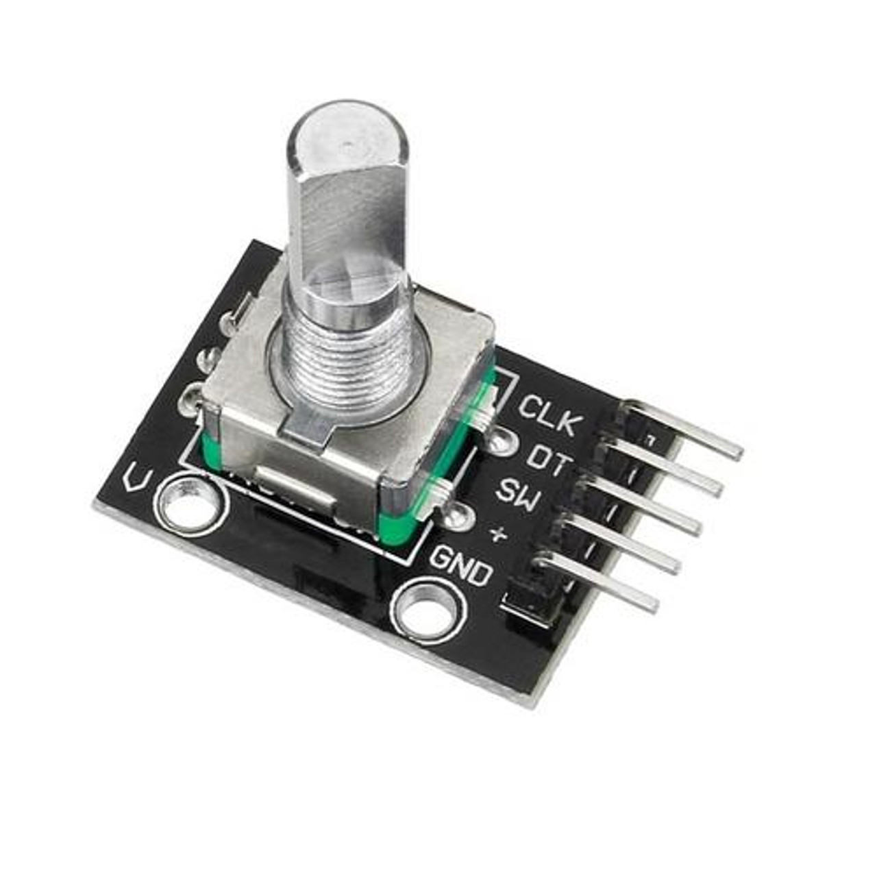

If it may help:
The rotary encoder is connected as shown in the code:
clock to D6
data to D7
switch to D5
The stepper (ULN9003):
IN1 to D8
IN2 to D9
IN3 to D10
IN4 to D11
Can you give us a link to the rotary encoder that you are using?
How are you powering the Arduino and stepper motor?

@JohnLincoln
This is the encoder used.
