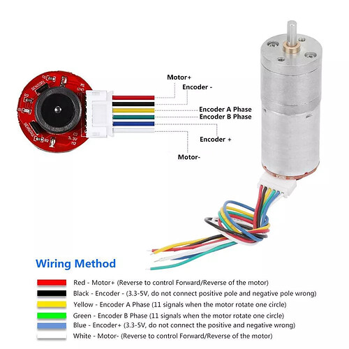

Hello everyone, I want to know how to set the error value for an encoder motor. I am using arduino mega and testing motor with encoder, also i have rotary encoder and lcd screen. When I set the number of revolutions of the motor, everything goes according to plan and the goal is reached without problems. But when the motor is under load, the encoder cannot always reach the set RPM (about 5-10 steps left), so it does not turn off by itself. Therefore, I had a question, how to set an error to the motor so that it does not buzz when it does not reach the target.

How about setting a time limit for the motor to reach its target position. If it does not reach the target within that time then take whatever action is appropriate
good idea, but the distance is not fixed, the motor can rotate both 5 seconds or 5 minutes
Do you know the distance in advance of starting to move ?
Measure current drawn, I suppose that under heavy load you’ll max out the current draw so seeing that value will be a sign that you are asking too much from your system
Or measure the actual RPM versus the expected one
No, it depends on the situation
okay, i will try to use your method
is the problem that the PID output, the PWM value is too low to drive the motor to reach the endpoint?
is this where the integral, I, term of PID can help generate a larger PWM value due to the integrated error? the problem is then how to "unwind" the I component when the error == 0
Your encoder does not set the rpm.
The rpm is a result of voltage, load and duty-cycle which will determine a certain current. And if your powersupply can't deliver enough current this limits the whole thing.
You could dismount = remove the encoder entirely. If you apply any duty-cycle the motor would rotate with the exact same rpm as with encoder.
Sure I know you are using the encoder to control rpm. But this is true for any given rpm. The encoder is not reaching the rpm.
You don't "set" an error to the motor. How should this work?
what do you mean by "that the motor won't buzz when the motor does not reach the target" ?
Are you overloading the motor that much that the rotor of the motor does not rotate anymore = is standing still and the high current drawn from the motor makes the motor buzz?
You have to describe your problems with more careful chosen words and in more detail
best regards Stefan
the libraries for the robotics group i work with allow driving the motors a specific # of encoder tics with a specified tolerance and a specified speed. i've seen the robot overshoot and reverse
the tolerance simply specifies a range within with the operation is terminated
buzzing results if the position isn't stable while being maintained as the encoder jitters and the motor is rapidly driven forward/reverse or the motor can't reach the target
Aha So "buzzing" means the motor is oscillating CW/CCW.
or it could be being pulsed by PWM, but PWM is typical above audio frequencies and may not be discernable
Thank you all for your advice, I solved the problem myself. After the movement, the motor has inertia, because of this, the encoder jumped a few steps forward or backward (depending on the direction of movement). In this way, I left an error of 30 steps (600 steps per revolution, not critical in my case)
 if (abs(rotaryValue - motorPosition) <= 30)
    digitalWrite(standByPin, LOW); //disenable motor driver
