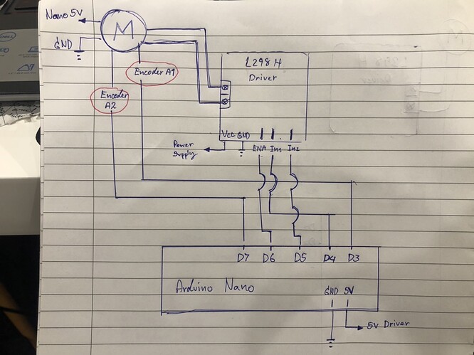

Please post the code You've got so far, and schematics.
That driver cannot handle the stall current of the motor (3 Amperes).

Sorry about the code and the drawing schematics, they are a little bit messy and un clear

Do NOT use the 5V Arduino output to power a motor. You can destroy the Arduino doing that.

Regarding the schematics, I would like to see the power supply, voltage, Amps.... (Very often the power supply is inadekvat. )

I have tested the circuit and it worked pretty well. I connected 2 motors (The motor) to L298N Dual H Bridge Stepper Motor Driver Board and the board used 7V from Power Supply machine, which Motor A connected to the 1 and 2 outputs, and the 3 and 4 outputs connected to Motor B.
The encoders which used 3.3V to 5V of both motor are powered another Power Supply, in this case, used 3.3V. The Signal of the encoder is detected by a scope machine.
However, I tested them without Arduino Nano.
So, could you please explain me a little bit about that? And if the driver cannot handle the stall current, how does it look like? e.g. it cannot rotate the motors or the driver will burn.
Thank you so much for your advice.
The link of the Driver:
so sorry, I want to make everything clearer to you but I am not sure how the make the schematics properly. I have no basis in electronic field, I am trying to learn about this.
I will use 7V to power L298N Dual H Bridge Stepper Motor Driver Board and the output 1 and 2 is connected to the motor and Arduino Nano will use 5V from the Buck converter which connects to Power Supply (7V). The Encoder A is connected to pin 3 and the Encoder B connects to pin 7, both encoders will power by the Buck converter as well. The In1 and 2 of the driver are connected to D5 and D6, the Ena (PWM signal) is connected to pin3.

This is a disaster. The more text the higher risk for misunderstandings. It gives no overview of the project. Pins here and pins there...... Useless information. That's the way the police works solving a murder, laying a jigg saw puzzle. No helper is fond of that.

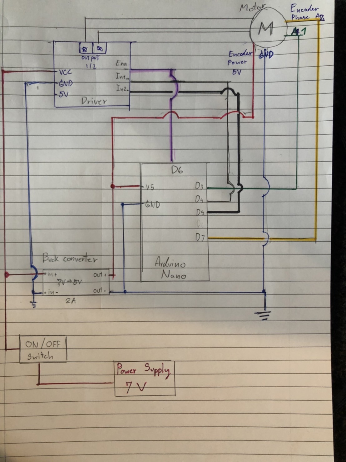

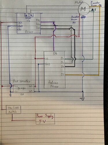

I am sorry for that, and hopefully, this schematics drawing will give you more overview.
If I did anything wrong, please let me know.

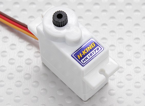

If you are new to electronics and new to programming then you should use an RC-servo
An RC-servo unloads the burden of making the feedback-loop from physical position to wanted position to zero because an RC-servo has the feedback-loop working.
If the task is to just turn an indicator needle even the smallest servo is capable of that.
Limiting facctor: turning angle.
Which RC-servo you should use depends on the required turning angle.
Here is a cheap one. Though I don't know what turning angle it has
https://hobbyking.com/en_us/hobbykingtm-hk15178-analog-servo-1-4kg-0-09sec-10g.html

One question about the 5 volt fed to the controller. Does the schematic say: VS or is it the 5v pin? It needs to be the 5 volt pin.
