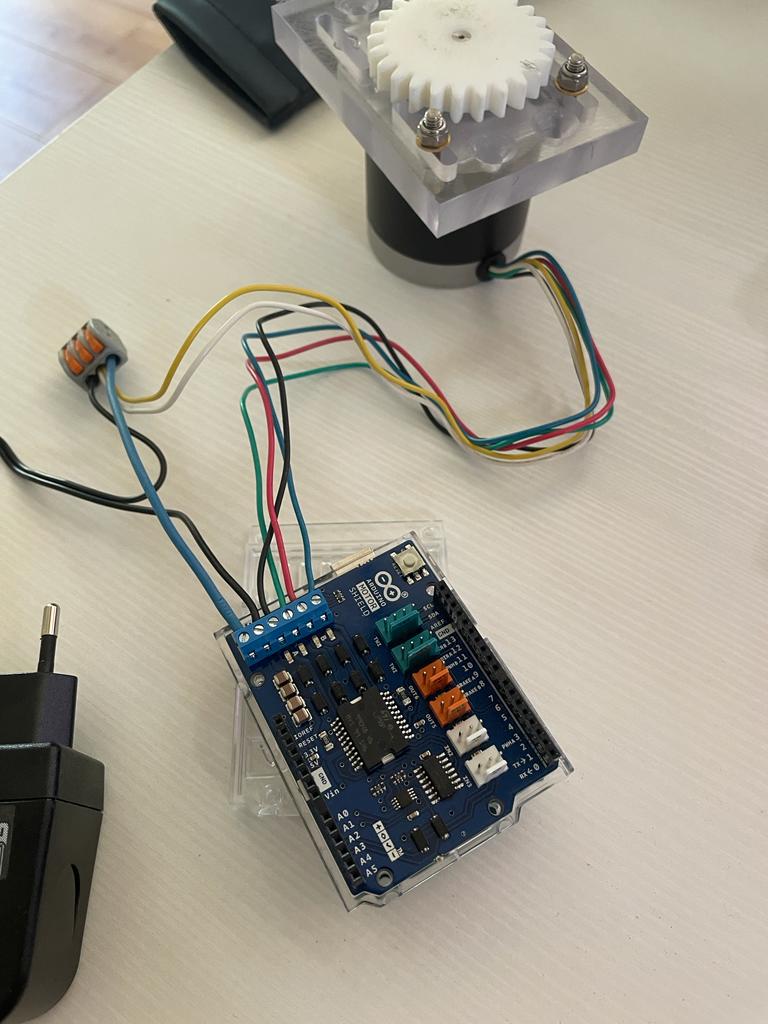

I'm developing a project for rotating solar panels.
Except that I'm better at mechanics than arduino :frowning:
I bought :
  • Arduino UNO
  • Arduino Motor Shield fixed on top
  • Unipolar motor
    Datasheet
  • power supply 12v DC max 24w
I connected the 4 phase wires to the corresponding letters in the datasheet.
And the 2 coms to the GND of the motor shield.
power supply (+) on VIN (-) on GND with 2 coms
Is there a mistake?

well, it is possible. but i am not sure if this motor shield is suitable for unipolar connection. probably you can leave this two middle point wires unplugged and using motor as bipolar. then test example sketch for stepper. then if it work adapting sketch to your purpose.
I can remove the com cable but then what do I do?
I look
but only for DC motors
yep, not suitable for your setup.
what com cable do you mean?
Yellow and white for the bipolar past as you said

Which stepper motor do you have exactly? The datasheet of your link in #1 contains 3 different steppers. Not all are suitable for your motor shield.
The shield ist for DC motors and voltage controlled bipolar steppers.
N.B. Your shield uses a very old H-Bridge, which produces very much power loss.
yes, good, remove them.
Ref : 1805283 on document
what should I use?
A unipolar will work as a bipolar? I don't understand how.
Now my arduino is no longer recognised by USB PC, yesterday it was very hot when I had the 12v power supply plugged in + 5v from the pc.
I think I fried it
How do you have the panel mounted so the weight is supported by a suitable thrust bearing? And how are you making the motor move the panel?
OK, this one should work with your shield. But I suppose if you omit the com wires and use it as bipolar motor you may need 24V ( two coils in series ).
