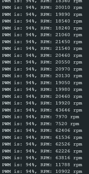

RPM control using PWM for blower ba5025h12b
for 100% pwm 40,000 RPM is what is expected as per datasheet im getting a sudden spike in between 34K in the above observation but again it starts to vary
is it because of arduino uno? due to noise and all? i've read it can prove to be inaccurate at times?
should i change arduino uno and use something else? But it is possible to get it with uno right?

i modified your code to find values from duty cycle of 0 to 100% in increments of 20% and its varying a lot from the datasheet

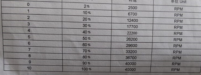

datasheet expected values :
Well, appears better what do you see with PWM 240, 192, 160?
What does the chopped off top line of that picture say?
columns heading are serial number,percentage,rotating speed and unit from the left most column

at 240 its varying too much again
That makes no sense, post your modified code.

What is the output?
in datasheet
What RPM reading with PWM disconnected?

i used the above code to measure rpm without pwm
output is:
ig its not full speed and is low when pwm pin is disconnected my bad
yet according to datasheet at 2% duty cycle its 2500rpm so like I'm confused
and when i set it to 2% its considerably higher
