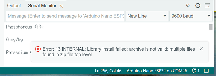

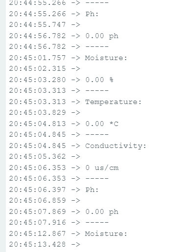

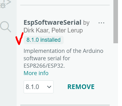

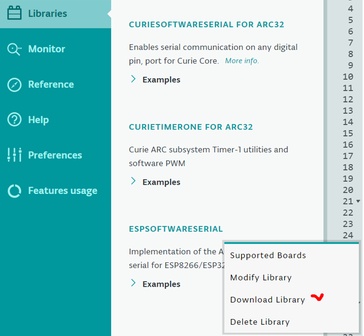

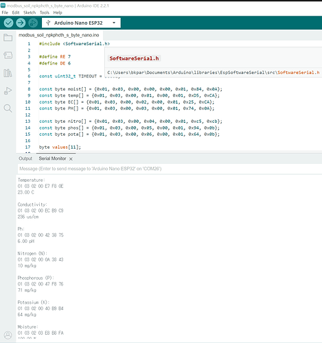

Hello
With the help of this forum, I was able to successfully use the Arduino IDE to read the values of a composite sensor over RS485. The command and response frames are the same for the sensors I used.
When I uploaded it again through cloud editor to control it through Arduino Cloud, I could not read the sensor values. I changed several variables and imported the latest ESPSoftwareSerial library used in PC IDE for ESP32 in Cloud Editor. However, I cannot read the sensor values.
Please advise Thanks
My advice: do not post screenshots of your code!
Just to clarify, your code works when compiled using the IDE but the exact same code does not work when compiled via the cloud.
I don't use the cloud setup, but can you download the SoftwareSerial library the cloud is using and try it via the desktop IDE?
Hello
I used the exact same code. I've posted screenshots to confirm other information. Here's my code.
Libraries downloaded from the cloud are not imported into the IDE. I imported the same library into the IDE and Cloud. The latest version is 1.8.2, which can be checked in the IDE and in the cloud.

esp_ver
I've seen in other forums that the compiler results of IDE and Web Editor are different. It seems to be mainly a library issue. I really want to try the compiler in the cloud.

Hi , im using a soil four parameter sensor, rs485, and arduino mega 2560. i tried the code but it didn't work, it only shows zero
this is the code i used

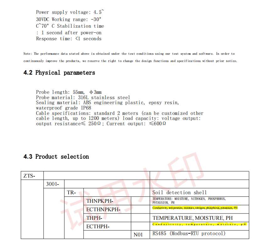

Do you have the datasheet for your particular sensor?
What does it say about the register addresses for the various soil parameters that it can measure?
Some sensors use 4800 baud instead of 9600 baud.
