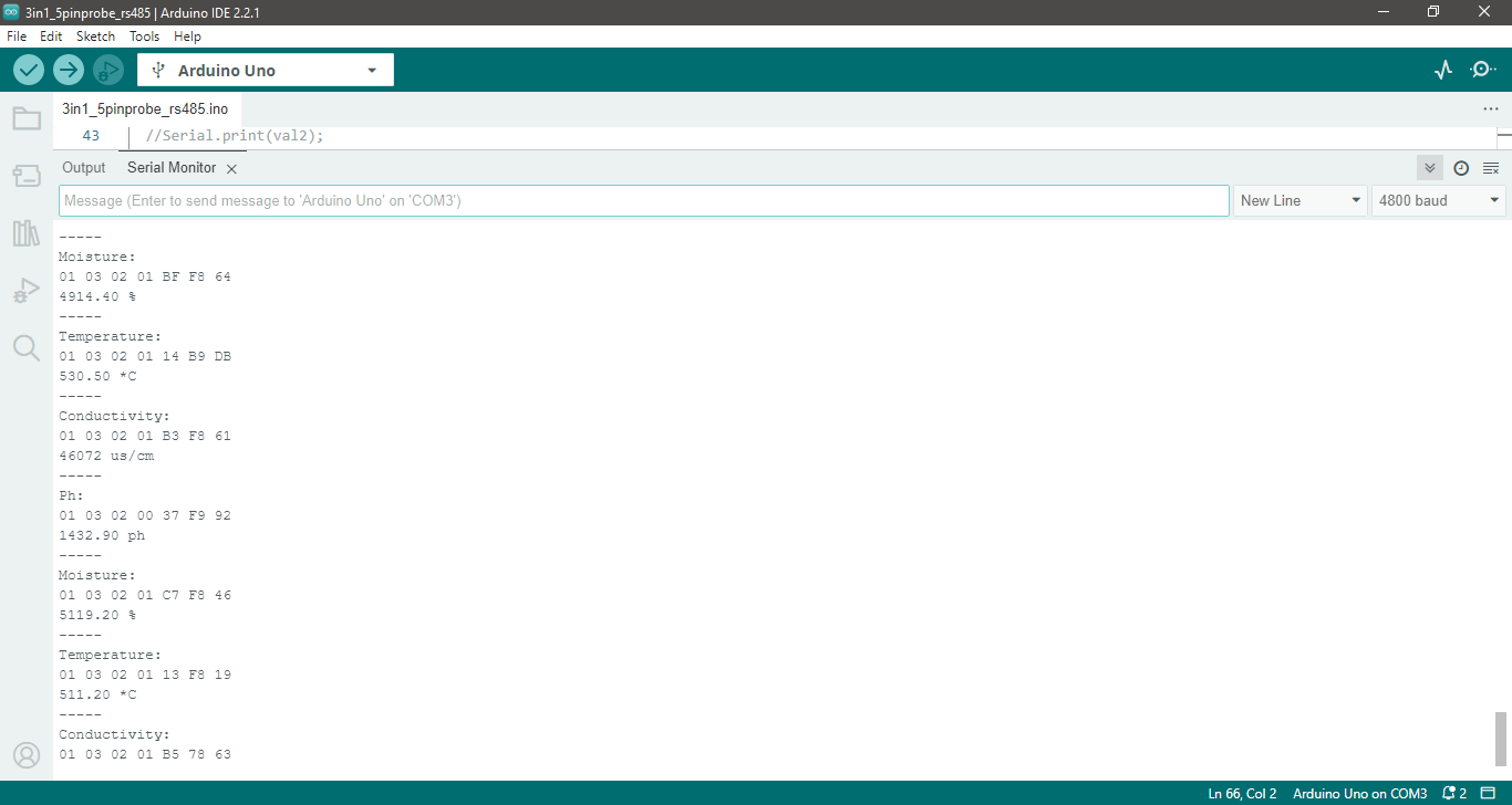

Can someone help me, for my 4in1 5pin probe RS485 THPH+EC Sensor, I have code but it doesn't read anything. I am using arduino uno for this

it only prompt like this in the serial monitor

after i run it on the compiler, it verifies and upload just fine but there's no output readings on the serial monitor even if i already put the sensor itself on soil
What is that stuff you showed on the serial monitor? Looks like reading values.
it only stays in zero
Did you ever read the value from the sensor?
no values at all as it only prompts zero, even if i already put the sensor in the soil
Then you need to spend some time debugging the code where you actually get those values.
now its giving me, a prompt like this
i only need accurate decimal values, can someone help :<<

What do you mean by this? The image in post #14 shows no errors.
how can i get rid of hex values and only print decimal values that are accurate
