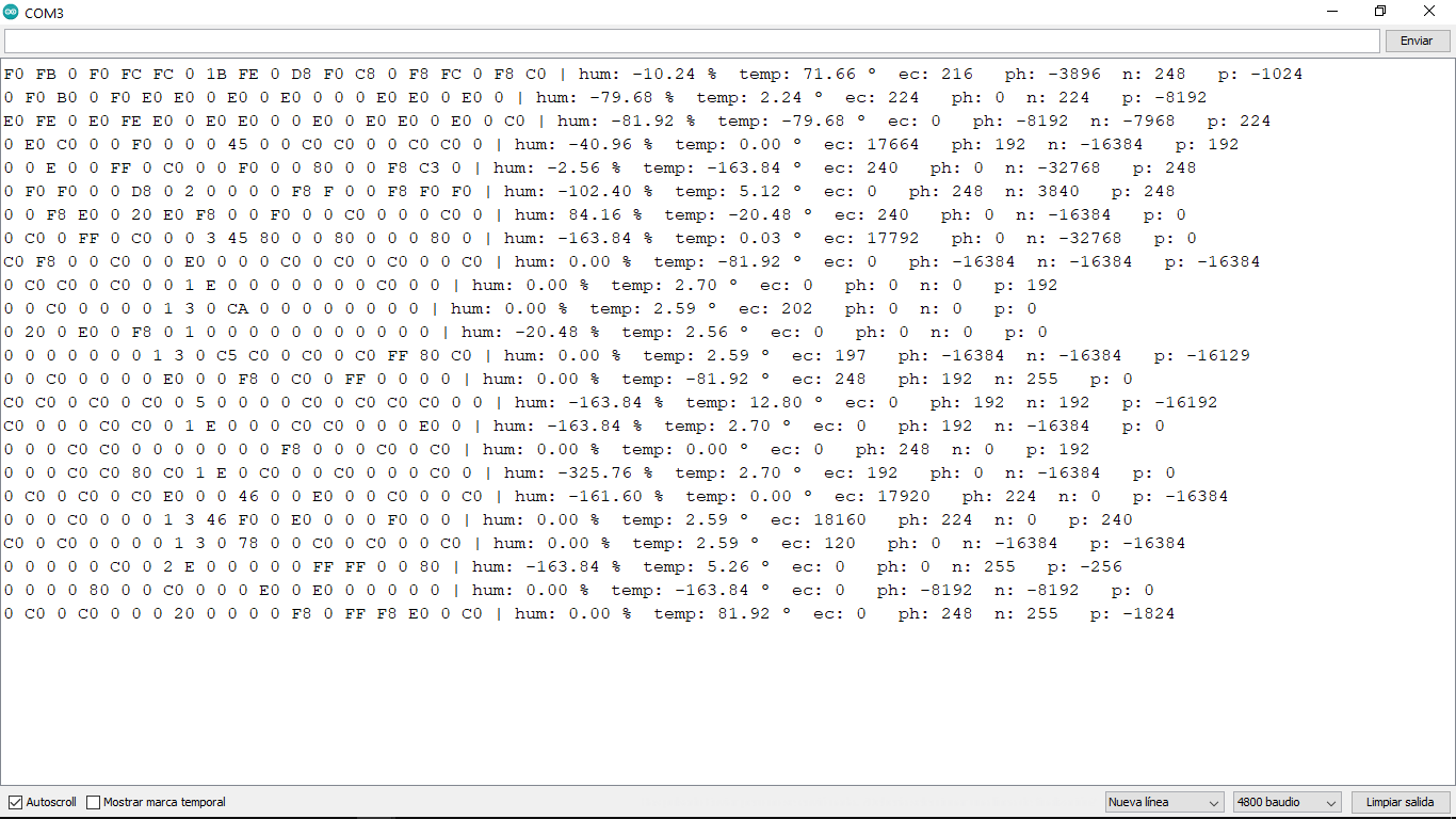

why doesn't your output show the line with " |HUM : " that prints?
Dear gcjr. The output show incorrect values like in the image
I have been trying to do 13 iterations to display the data from position 4 of the array but I am not sure if it is the correct way.
Please, any ideas i'll appreciate a lot.

Your output looks like it was produced by a different version of your code - I don't see hum or % for example.
It's confusing too because it looks like you read characters one at a time but you're printing values you haven't received yet. I suggest that you read them all and then print once.
Finally, you are reading without checking if there is anything there.
Your original image above shows a response containing 19 bytes. You would have to read all of them. Response #5 looks like the values are shifting around from read/read due to not reading them all.
Do you have a datasheet for this sensor the describes all the packets and responses?
As @blh64 says, please post a link to your datasheet for the NPK sensor you are using.
Previous attempts to use this type of sensor that have been discussed in this forum revolve around just nitrogen, phosphate & potassium readings. In those cases, each value had to be requested separately as shown in the original code you linked to in #1.
I've not seen a version of NPK code that requests all readings in one command. That's where the link to the datasheet detailing the supported modbus commands & responses would help us to help you.

The response data frame that the supplier has given you doesn't look right. If the number of bytes in the response message is expected to be 14, then that's not 0x14, it's 0x0E.
The expected response sequence starting "0x01 0x03 0x0E...." appears on the top line of your output screenshot. It doesn't appear anywhere else.
Before figuring out how to decode the data, I would suggest that you work towards getting a consistent reply from the sensor, so that each received response starts with the correct preamble.
Have you got the RS485 bus termination resistor setup correctly?

01 03 0E 00 00 00 F3 00 00 00 46 00 00 00 00 00 00 C4 96
HEXADECIMAL: 0E
DECIMAL: 14
Is the printing of the values ​​ok? Or should I do otherwise?
Please @markd833, @Faraday, @wildbill, @blh64 , @gcjr . Can you help me to achieve this issue?
Any help or suggestion is welcome. I'll be very greatful :pray:
You are still not using mod.available to check that there is something to read so your positions in the response frame can be off.
Still the same :,
Post your latest attempt and its output.

and the outp are those:
Any idea or suggestions? What can be wrong?
The normal temperature here is above 21º degrees and the humidity is over 60% percent.
The purpose of mod.available is to see whether there is anything to read. You may find that it takes the soil device a while to respond. Similarly, there's no guarantee that because one character has arrived that they all have.
In consequence, you should never use read anything from serial until you know it's there. Your current code isn't doing that yet.
4800 baud is slow compared to how fast your processesor is running. Something like this should help
//Library to convert Digital Output pins of the board to transmitter as well as receiver
#include <SoftwareSerial.h>
#define RE 8
#define DE 7
const byte requestframe[] = {0x01, 0x03, 0x00, 0x00, 0x00, 0x07, 0x04, 0x08};
SoftwareSerial mod(2, 3); // RX, TX ( Creates a new SoftwareSerial object )
  Serial.begin(4800);
  mod.begin(4800);
  pinMode(RE, OUTPUT);
  pinMode(DE, OUTPUT);
  Hum();
  delay(3000);
void Hum() {
  int valueRaw;
  float valueReal;
  unsigned long startTime = millis();
  const unsigned long timeout = 5000; // milliseconds to wait
  byte values[19];
  int idx = 0;
  digitalWrite(DE, HIGH);
  digitalWrite(RE, HIGH);
  delay(10);
  if (mod.write(requestframe, sizeof(requestframe)) == 8) {
    digitalWrite(DE, LOW);
    digitalWrite(RE, LOW);
    // we expect the preamble 0x01,0x03, the count 0x0E, the data, and the CRC 2 bytes == 18
    while ( idx < 18 ) {
      if ( mod.available() ) {
        values[idx++] = mod.read();
      if ( millis() - startTime >= timeout ) {
        Serial.println( "Timout" );
        return;
    for (byte i = 0; i < idx; i++) {
      Serial.print(values[i], HEX);
      Serial.print(' ');
      delay(10);
    Serial.print(" | ");
    idx = 2;  // skip preamble
    // first humidity
    valueRaw = values[idx] << 8 | values[idx + 1];
    valueReal = valueRaw / 10.0;
    idx += 2;
    Serial.print("hum: ");
    Serial.print(valueReal, 2);
    Serial.print(" %");
    // temperature
    idx += 2;
    Serial.print(", temp: ");
    Serial.print(" º");
    // ec
    idx += 2;
    Serial.print(", ec: ");
    // ph
    idx += 2;
    Serial.print(", ph: ");
    // n
    idx += 2;
    Serial.print(", n: ");
    // p
    idx += 2;
    Serial.print(", p: ");
    // k
    idx += 2;
    Serial.print(", k: ");
    // the CRC
    // TODO: validate it is correct
    Serial.println();
Initialising the state of RE & DE in setup() may also help. Something like:
Have you got your A & B wires crossed over, as there doesn't appear to be a repeatable pattern received in response to each of your commands.
