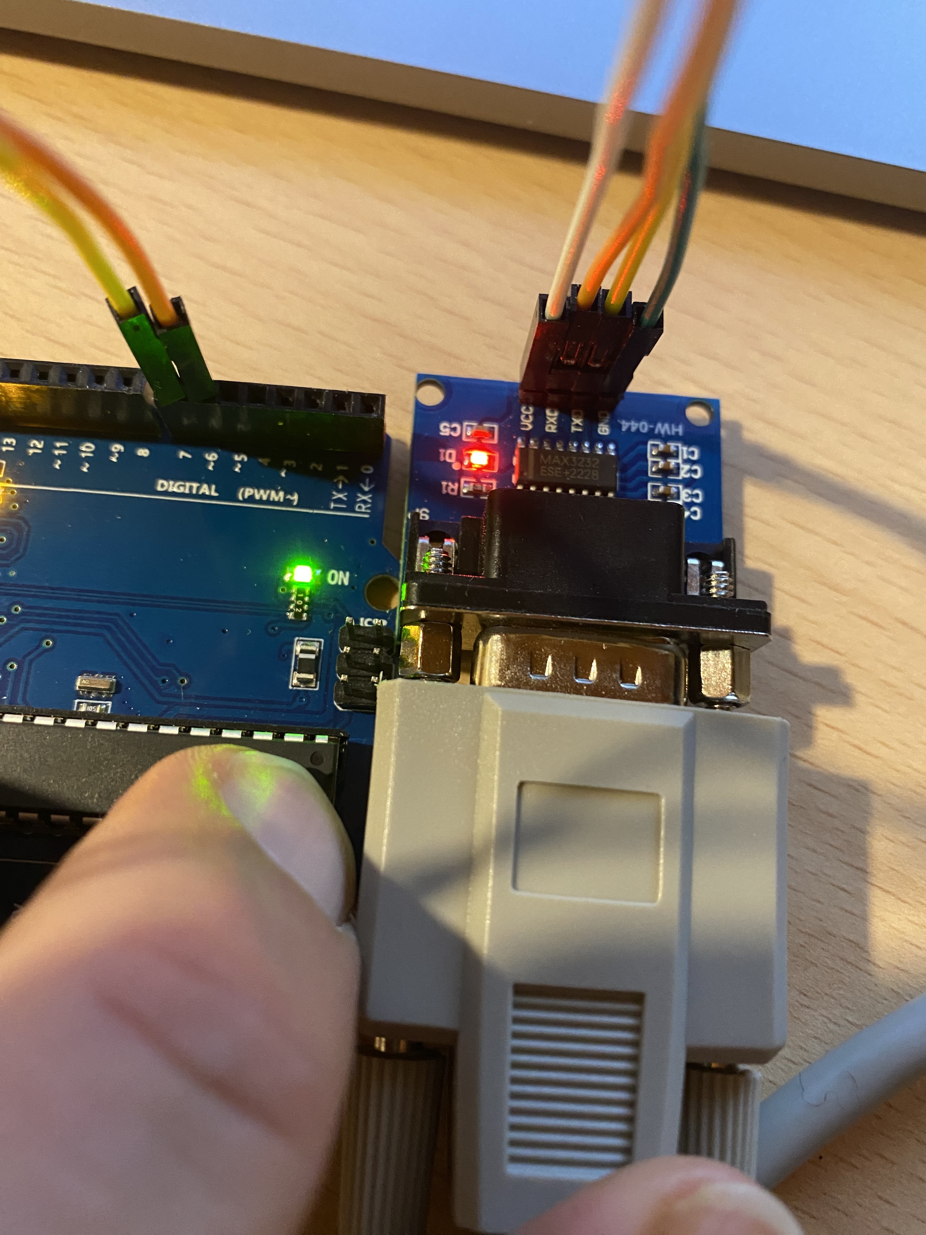

Post a picture of the hardware setup.

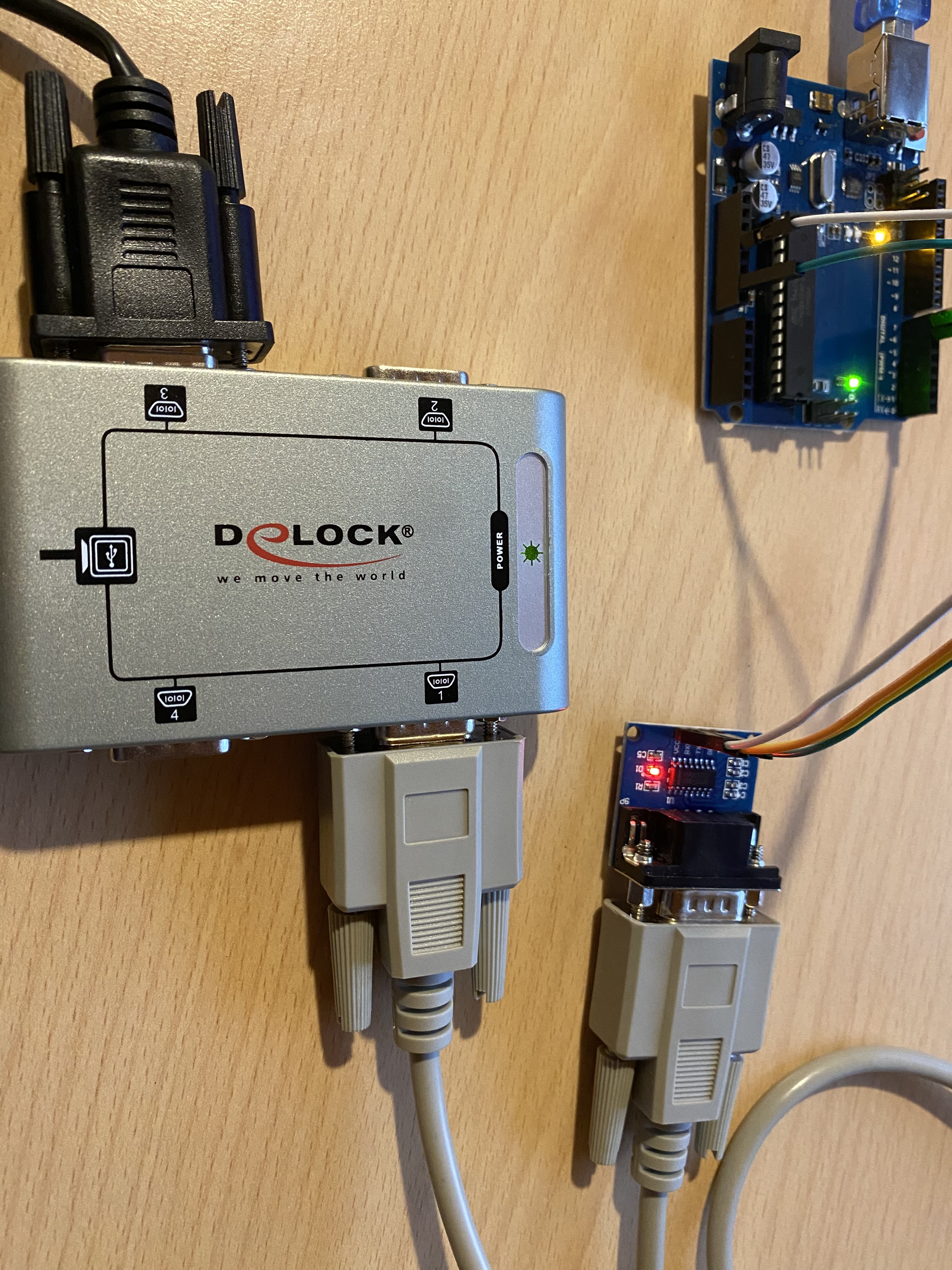

What I have done is take the cable out of the equation and connect the rs232 shield directly to the serial hub. Not sure if this removed the cable crossover issue?
The data sheet doesnt say, but I'd assume the shield is already connected as a null modem.

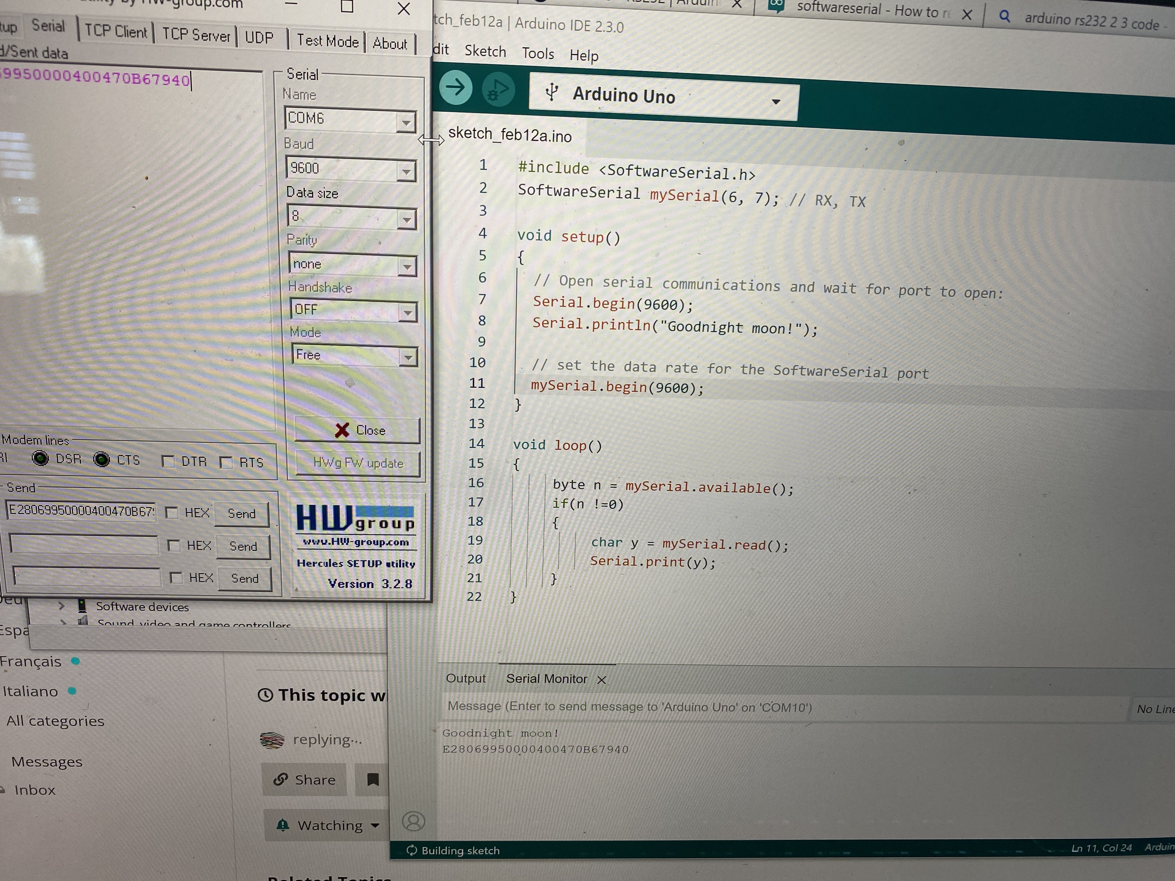

Can you post your code please?
#include <SoftwareSerial.h>
SoftwareSerial mySerial(6, 7); // RX, TX
  while (!Serial) {
    ; // wait for serial port to connect. Needed for native USB port only
  Serial.println("Goodnight moon!");
  // set the data rate for the SoftwareSerial port
  mySerial.begin(9600);
void loop() { // run over and over
  if (mySerial.read()) {
    //mySerial.write();
    Serial.println("Data available");
    Serial.println(mySerial.read());
  if (Serial.available()) {
    mySerial.write(Serial.read());

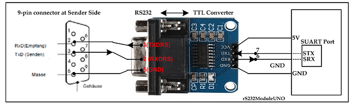

1. Check that the UNO and RS232<--->TTL Module connection agrees with Fig-1.
Figure-1:
2. Upload the following sketch (yours' one of post #9 with slight modification.
     byte n = mySerial.available();
     if(n !=0)
          char y = mySerial.read();
          Serial.print(y);

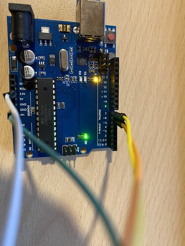

I can't see anything connected to pins 6 and 7 in your photo.
i have confirmed ground is passed all the way through.
using a multimeter, should TX and RX have passthrough? i guess not. 12V vs 5V TTL
1. Check the following connections:
RS232<---->TTL Module              Arduino UNO
TXD-pin                            DPin-7 (DPin = Digital Pin)
RXD-pin                            DPin-6
VCC-pin                            5V-pin
GND-pin                            GND-pin
2. What do you expect to see on the Serial Monitor -- digits (0 - 9, A - F) or alphabets (A - Z, a - z, etc.) or both?

Difficult to make proper photo but here we go.
i have also uploaded the code as you can see...
Better to apply VCC = 5V instead of 3.3V as you have iterfaced RS232/TTL Module with UNO which is 5V device.
