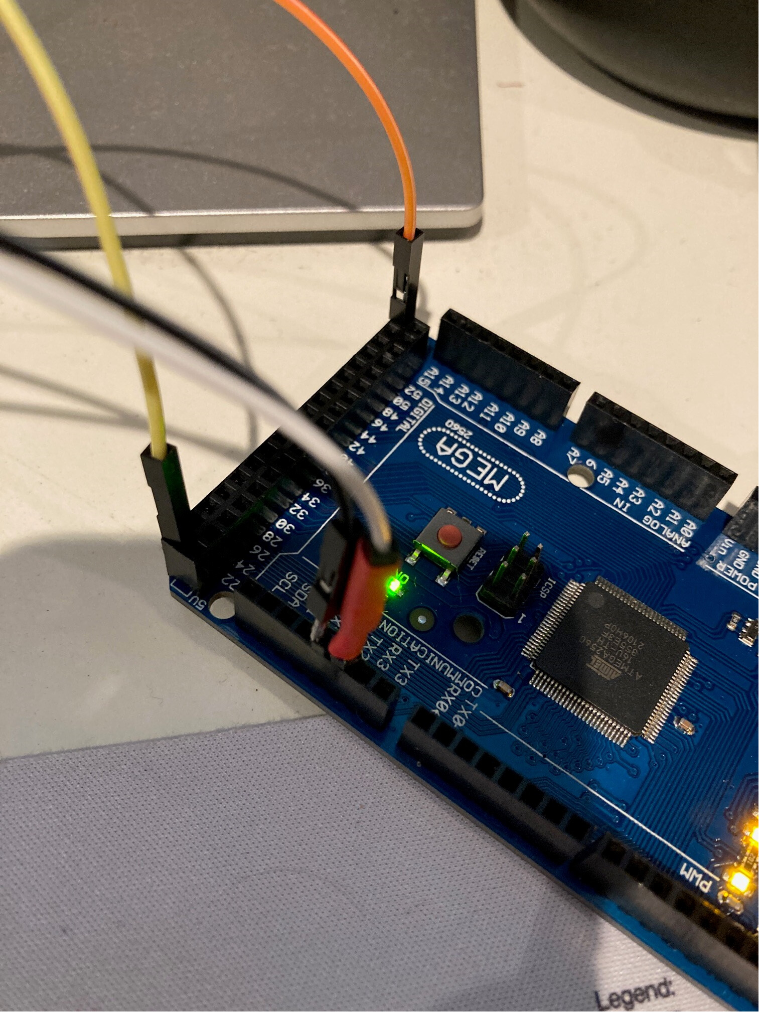

I have the device connected to 5v, ground, TX2/RX2.
I wait to see 10h from the device then send 20h to accept the next transmission where i expect to see 08h but never see it. I do some some bytes come through but the results are all over the place, no consistency and I cannot decode it into anything that makes sense.
I am using an adapter (2 actually) JY-R2T V1.4 and HW-044:

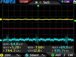

When I check the volts (DC) on the output of the device (which is a 2.5mm stereo plug) I see:
4.2v between the middle band and the ground.
0.8v between the tip and the ground.
The base band is ground.
The 4.2v drops to 4.0v and keeps going between the 2 values in a steady fashion when the probe is in use during a measurement activity.
The 0.8v seems to drop to 0.1v then doesn't do much after that.

I believe this is more correct but still I don't know how to decode the feedback or whether it's even giving me back any real data at all.
The RX and TX lights never blink on the RS232-TTL Adapter.
The TX light on the Mega 2560 is lit constantly, no blinking.
The RX light on the Mega 2560 remains unlit the whole time.

I think your wring is incorrect.
Unlike connection between two RS232 devices, connection between MCU and TTL to RS232 module should be:
  • Arduino RX pin should connect to RXD of RS232 module
  • Arduino TX pin should connect to TXD of RS232 module
You can see the wiring diagram and test code in this Arduino RS232 tutorial
Here's the output of the device when it's not plugged into anything:
81
And here's the output when I'm actively measuring a piece of steel:
83
EDIT:
Changed some settings and got what I thought I might see.
84
Where do I look next? The saga continues......
Thanks !
If you want to verify the wiring of the RS-232 adapter board, you should be able to do a loopback test by connecting pins 2 & 3 of the 9-pin connector together.

4800 baud would be a base frequency of 4800Hz, or a pulse width of a little over 0.2mS, far from what you show in the pictures.

It looks to me like you missed to connect GND or measure AC instead of DC-
