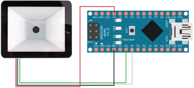

Circuit, this is what I'm currently following
I'm using an arduino nano, the scanner I got from shopee, connector wire, a breadboard and my laptop. I have the latest version of Arduino IDE installed
The scanner description on shopee says that it uses 3.3 to 5V which falls in range to what an Arduino nano needs right? So why does it need an RS232? and why has the data I receive are all random symbols? I currently can't get a picture of my materials since they're at school and my arduino nano doesn't work anymore

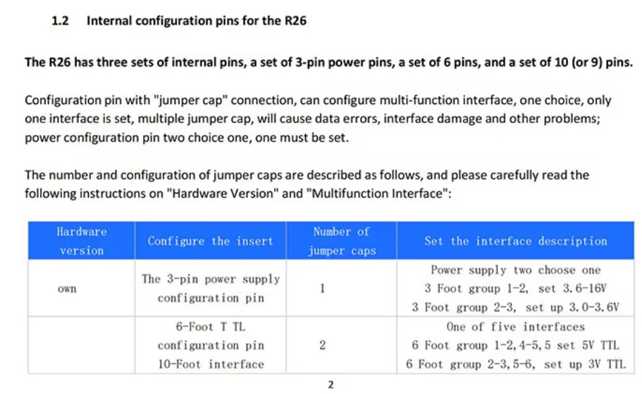

Is this your scanner?
Where did you get the RS232 output info?
What speed is the output?
Thanks.. Tom.... :smiley: :+1: :coffee: :australia:
Yes that is it
I don't know what you mean by that, I assumed it used RS232 and I asked ai what it meant and if I should use it instead of Usb.
It should be 25cm/sec according to the specs if that's what you're asking. If it's the baud rate then I don't know, it doesn't specify

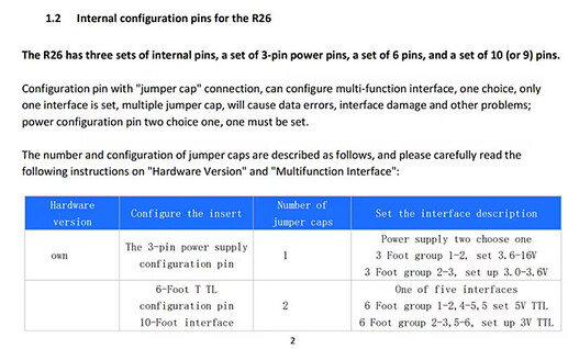

Should be 9600. According to manual found here, you don't even need RS232. You should be able to configure the scanner for 5V TTL output with jumper settings.
You find instructions here:
https://aliexpress.com/item/1005006809934051.html
Thank you for the manual, the page on shopee doesn't have one

Your scanner has jumpers to set the type of interface, you need to know what those jumpers are set to.
