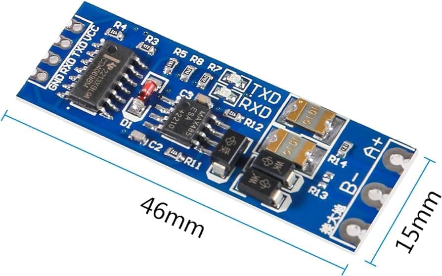

Got a uart-to-rs485 converter board from the Ali.

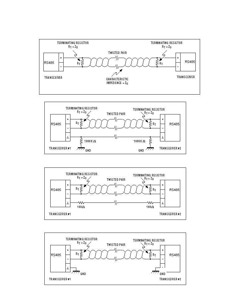

Its schematic is very close to this one:

The question is: should I leave it like this (open) or short if all I want is to connect 2 identical modules to make a communication line between two UARTs? The picture below is what I bought, R13 seemed to be R0 from the pic above
I think you need to short R0 (or fit 0R resistor) in this case. Refer to the datasheet:
Figure 21, page 13
Looks like that yes. On both ends. Thanks!

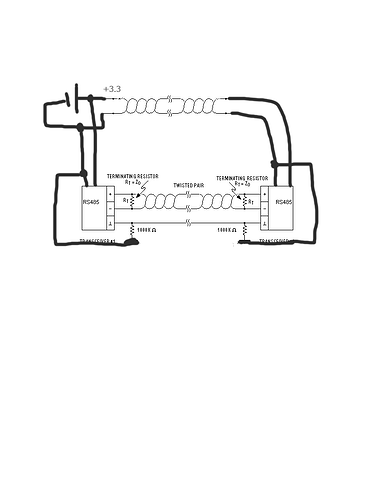

I'd opt for this if you can spare the additional conductor:
No, it's a ground reference. I think it's a good idea to use it to reference both modules to the same GND level because there's no isolation of the actual signal lines.
Ground reference is not actually required, the polarity of the A & B lines define logic HIGH or LOW. Typically GND is used to shield the lines (as with DMX) and in that case may as well be only connected at one end. If GND is connected at both ends, an electrical mishap on one end can cause damage on the other end. If that can not happen there is no risk involved in connecting GND at both ends.
as long as a 2 way transmission between 2 devices, than yes a 120R terminator at both ends. In case of a one way transmission only at the receiving end. With multiple devices use a maximum of 2x 120R terminators at the end of the rail. (or just the one if it is a one way transmission)
Like this?

You have obviously never used it at all. The picture in #3 should give you some idea of the options. (i did not post that)

And this is from the Maxim datasheet, None of the images show a shared GND anywhere. To be fair i was under the same impression as you were until it was pointed out to me that common GND was not part of the MAX485 connections. (or DMX specification where i use them most)
None of the images shows any connections to Vcc or Gnd. These are only informal images regarding the data connections.
Both ends are not galvanically isolated. The common mode voltage range of the differential receiver is limited, so driver and receiver need a common reference. And that is Gnd.
  1. Module is clearly doing the 'turn around' internally, if you actually look at the schematic. No access to DE/RE is provided. While this suffices 'most of the time', these modules can sometimes be a problem. The OP will have to determine correct functionality.
  2. For a two device connection, jumper in the 120 ohm resistors at both ends.
