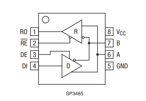

Hi all,
I'm trying to deploy RS485 communication using the Portenta X8 as the server.
I'm using MaxLinear SP3485 - RS485 driver.
From the python-periphery lib I'm using Serial
I'm using the UART Tx(DI), Rx(RO) and gpio for switching the RTS (RE/DE) from the linux side
I'm using Oscilloscope to check if it's working:
  • Tx is working fine
  • Rx is always remain 3.3V (high) - I guess it's because of a pull up resistor
The result is that the communication isn't working, I don't get any reply from the other RS485 devices.
In the past I did the same with the Arduino YUN using SoftwareSerial and it worked perfectly
How can I resolve it?? please help!
Many thanks!

If the board actually is powered by 5V the signal level is the same and that may fry your Portenta pins.
As to the high pulling, I quote the datasheet:
The receiver is equipped with a fail-safe feature that guarantees the receiver output will be in a HIGH state when the input is left unconnected.
That could be interpreted that the RO pin is pulled high if the line is not used.

I moved the "time.sleep(0.1)" to be after the writing part. the switching was to fast so only half of the burst went through the RS485 driver in writing state.
now it's working
