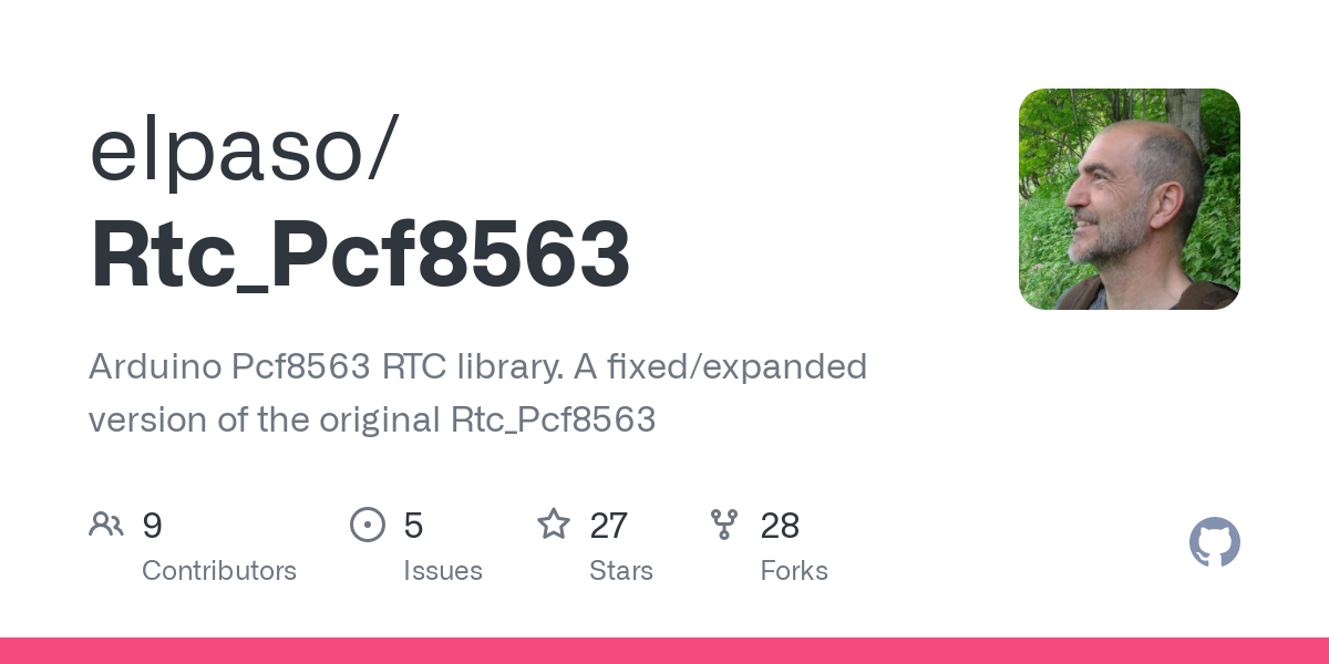

Thanks for all the help guys, using pull-up resistors did the work, also some libraries are not optimized well so use this library if you want this specific chip to work well:
