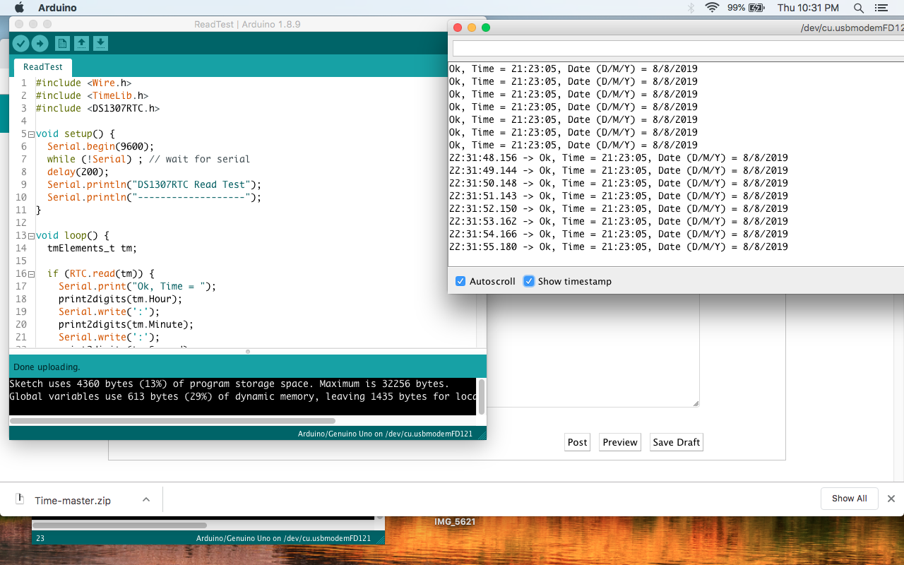

Hi and thanks in advance for any help.
Basically, I'm working on a light dimmer project (first ever) and am running into some trouble with the RTC. I have a DS1307 that came with my starter kit from Elegoo and it won't update the time. I'm able to communicate with it and the serial monitor shows that it is running but the time doesn't change. I'm using the adafruit RTC library: GitHub - adafruit/RTClib: A fork of Jeelab's fantastic RTC Arduino library and using the examples that it includes.
I know I am communicating with the module as I have been able to change the date/time (but now can't) and the softRTC example works just fine but I would rather use actual date/time rather than just elapsed millis()
I used the included example "ds1307"

[/code] with the line to update the date/time to current upload date/time as active. It shows the date/time that was stored in the module from another library that I tried... This is also the case when I try to manually set the date/time using the "// January 21, 2014 at 3am you would call:" example.
Before I tried the other libraries, it updated the date/time to current with upload but would not progress. When I use the softRTC it auto updates to current date/time of upload and proceeds appropriately. Do you think this is a hardware or program issue? I am stumped!

Thanks Romonaga for your input. I checked out that thread and tried the library mentioned there. I was able to change the time but it still does not proceed. When I run any example code to set/read the time, it just returns the same time over and over...
Any other ideas?
Am I missing something else?

@CrossRoads (yes, I know this thread is old, but it seems incomplete),
You are usually dead-right on your advice, but when running he above code, I only get:
Hrs FF Mins FF Secs FF Day FF Date FF Month FF Year 20FFFFFFFF SquareWave FF
over and over and over.
So what does that mean? I'm starting to think my Board is bad, but I have 2 "RTC boards" and both throw the same result
