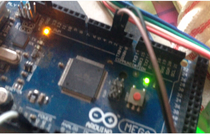

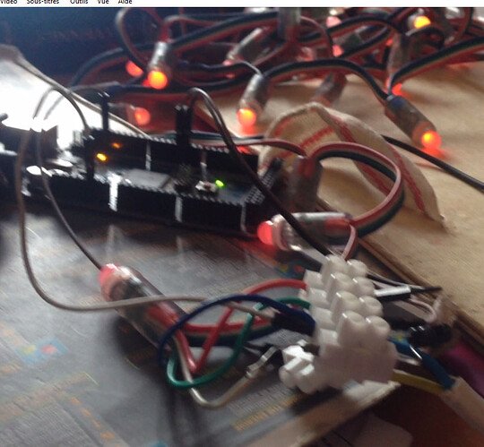

J avais acheté il y a longtemps un ruban 5m 50 leds que je n avais aucune idée comment l utiliser et voila depuis 2 jours en naviguant j ais trouvé la bibliothèque qui marche avec Adafruit RGB Pixels
(Written by Limor Fried/Ladyada for Adafruit Industries. BSD license, all text above must be included in any redistribution
adapted by niq_ro for 3 LEDs niq_ro is Nicu FLORICA from http://www.tehnic.go.ro & http://www.arduinotehniq.com )

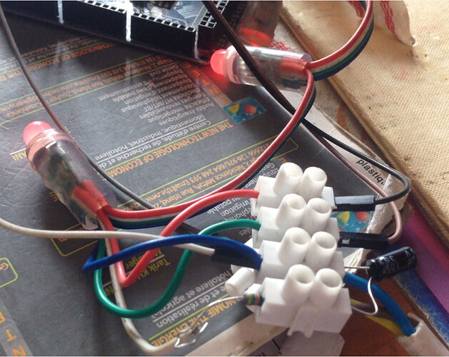

J ais branché les fils comme suit:
Blanc au 12 v 8a avec R 470 ohms
Bleu a la masse avec condensateur 10 mf 35 v reliant 12 v masse
Vert au clock
Rouge au data
Les Leds s allument clignotent seulement en rouge et vert (voir vidéo)

There are (as far as I know) 2 kinds of RGB pixel:
The simplest are just 3 (red, green and blue) LEDs on one chip, and are typically supplied on tape or other form and designed to be fed from 12v. I think this is what you have. They are controlled by using PWM for each colour to vary the brightness. There is no control over each individual pixel, you can only control the brightness of every LED of the same colour to the same brightness along the string. To power them you connect +12v to the white lead and 0v to each of the red, green and blue leads, typically through an N channel MOSFET to turn the current on and off. There is no data connection. You cannot connect these directly to an Arduino, you must have some kind of driver with MOSFETs. If you do connect it directly to your Arduino you are likely to damage it. You are safe to connect +12v to white and 0v directly to each or any of the red green and blue wires, which will light the corresponding colour of each pixel.
The other kind, which you don't have but which I think you think you have, has individually controllable pixels. This kind has 3 wires, one for +5v, one for 0v and one for data. This kind allows you to send data to every pixel to control the brightness and colour.

Quand vous dites longtemps, cela représente combien de temps ? Votre guirlande est peut-être composée de leds RVB basiques. 3 broches pour les couleurs (Rouge, Vert et Bleu sur vos photos) et une broche commune (cathode ou anode) en blanc.
