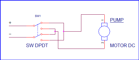

How did you want to do this? Can be as simple as a DPDT switch, using an H bridge or using a pair of relays. Much of this depends on your pumps voltage and current demand.

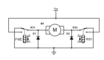

Also you may want to add a flyback diode on the motor to lessen the load on the relay contacts, which in case of a reversible motor amounts to a bridge rectifier.
If you're using a motor driver (H-bridge) you don't need this.

Just for future reference a DPDT Switch is a common Double Pole Double Throw switch in switch speak. The idea be it a switch, relays or an H Bridge is to simply reverse supply power to the motor. Using a DPDT switch and applying it in schematic it would look like this:
Paul provided an example using a few relays.
Ron
Flyback diodes are D1 and D2 in this drawing, they suppress the "kickback" spike from inductive loads.

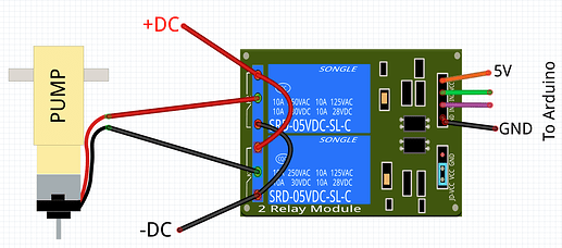

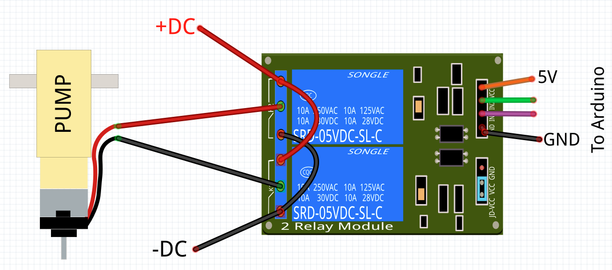

@Patrick_2
Turn on one relay to make it go one way
Turn on the other relay to make it go the other way.
