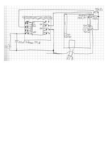

So I am trying to get this to work for me but I keep getting the following error.

So I have it semi working. as in I am able to set the time of the RTC. The following is my code to set and display the time.

however when it prints out it gives a weird number for seconds and it does not increment the time, such as the following:
9:10:85 13 4 12

I don't know why that does not work for you, for me it works fine. I have done another version using C++ classes. you can try it:

if you have problem also with this try to check how you physically connect the rtc to the microcontroller.
Hi guys
I have the same problem.
Do somebody know the solution of this?!?

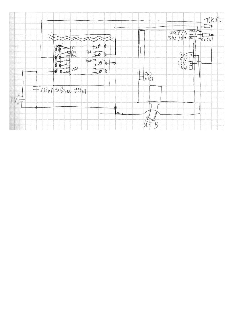

I have tried both codes before and get 85 for the seconds everytime. :frowning:
I have saved my problem. It's reason was a failure in the wiring of the hardware.
The items I used were
an Arduino UNO
a RX-8025SA Clock Module
a coin cell (CR2032)
an SMD-TSOP Multiadapter
two 10k? resistors
and a 333nF Ceramic Condensator (a 100nF would be better)
The RX-8025 was soldered on the Multiadapter by me and all items were mounted on a patch panel.
The wiring map shows the RX 8025 on the Multiadapter. Be careful to solder every second pin to the pin you put into the patch panel, because otherwise you have to build bridges from the pins which are not connected to the panel to free pins in the other row.
I attached the wiring. It is working quite good. I post it, because I don't find a complete wiring map on the internet.
I hope it will help someone who has the same problem.
