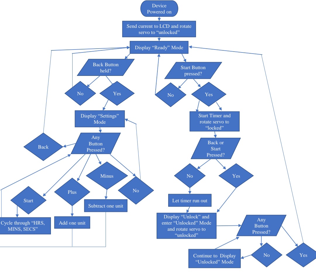

I want to create a safe box with timer
Set the time with the 4 buttons then the servomotor will turn to close the lock
When the count down is done the servo motor turns again to unlock. This is the flow chart of the original project:
Thank you for your time

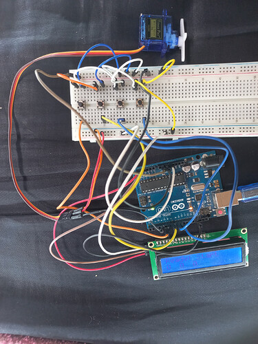

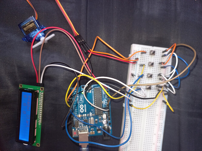

Sorry I mean circuit.
If I need to add any connection or remove it .
Especially the 4 buttons cause I changed many times the places of wires and still can't work. Thanks for your interest
The first text is the only thing that worked . All the following steps still stucked . Even the LCD doesn't react to any push button.

rectangle block can not have two outputs, only diamond block (you have it as skew quadrangle).

OP did not use pull down resistors, so the button inputs were floating, resulting in random triggering of the inputs.
It would have been better if the buttons were wired between pins and ground,
with pull up enabled on the pins with pinMode (no resistors needed).
Note that logic is now reversed. Pin is normally HIGH, and LOW when button is pushed.

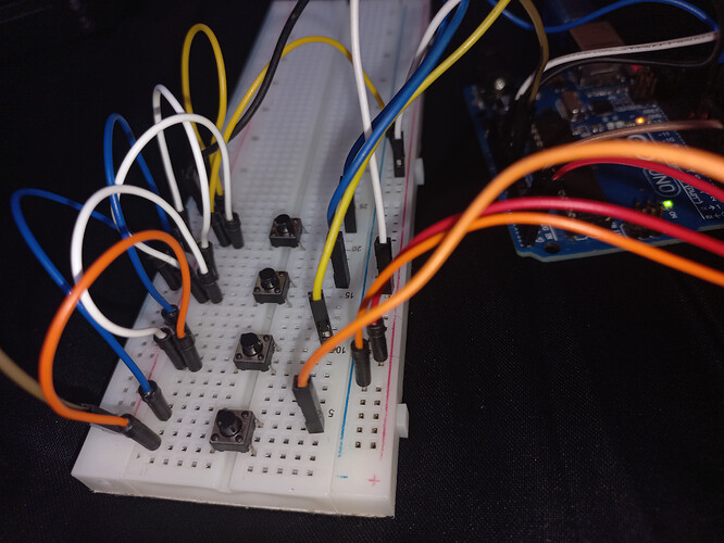

I THINK the buttons are wired as changeover, with one side maybe to +5 and the other maybe to ground. Out of focus pic and untidy wiring doesnt help.
So start by wiring the buttons correctly, and checking they work.
You've gone from walking to ferrari and missed out the "learning to drive" step!

Do you have a DMM, to check if the tactile switches are actually connecting with the protoboard?
I though the poster assumed that too, which tact switches are not.
