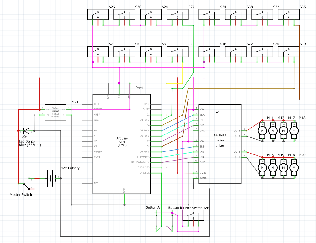

I'm making Jayce's hammer from Arcane for a cossplay and i've got the following circuit thought out using an Arduino and i was wondering if this is generally safe to build into my hammer or that i should maybe add a fuse somewhere or resistors to improve the working and safety.
The idea is as following:
A 12v battery pack directly connected to a master switch, powering a string (or 2 or 3) of 12v blue LED's, a XY 160-D motor controller and a buck convertor.
The buck convertor powers the Arduino.
It has a bunch of limit switches (2 for each motor on either end of travel) for safety and the total amount of motors is 16. If i was any good at using motors i could probably get away with a few less, but it is what it is. In the circuit i've only drawn in half of the motors and limit switches.
It also has 2 push buttons connected to another limit switch to control the motor action.
I've not yet wrote the code but it's pretty straight forward; When one of the push buttons is pressed, the motors either move clock- or counter clockwise, if one in a group of limit switches is tripped, the motors stop., preventing any movement in that direction.
Verify what's the actual voltage of your battery from full to empty. For 3S li-ion it would be ~9-12.6V. Is that ok for your motors/LED string? Is your battery discharge rate ok for the total motor current? Can your driver handle the needed motor current?
You need pulldown resistors for all of your switches inputs. Your LED symbol is backwards.
Also make sure your battery pack has protection circuit needed for safety!
Not necessarily. Wire C pin to GND and NO pin to the Arduino digital pin, and make things easier with the ezButton library.
That library defaults to using the Arduino built in pullup resistors and sets debouncing time in setup.
Safe as in will you get electrocuted? Yes, it's safe, just be sure to prevent any possibility of a battery dead short. The hobby RC car world would have lots of options for lipo batteries that will last for the duration of a Con, as well as staff who can advise you on an appropriate charger and general lipo safety related to fire risk.

In general, should be good, don't forget a ground lug (all grounds connect together).
Automotive supply houses are a good place to find suitable gauge wiring (I'd go 14AWG at least, depending on how many motors run at a time) and for a durable project that gets tossed about in the car trunk and generally used, switches, fuses (yes, use one between the battery and the main power switch).

I've changed the switches to use ground and INPUT_PULLUP. I'll add a fuse.

No one can say if it will be safe until you post the data sheet for this battery pack and for the motors.

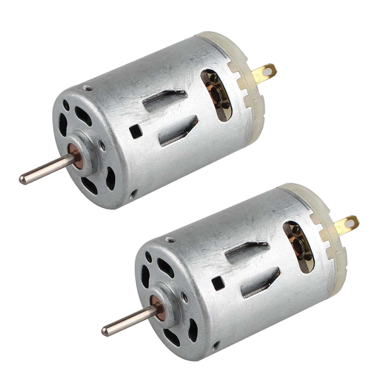

Changed the url for the battery, these are the motors:
Specifications:
Product Name: DC Micro Motor
Model: 385
Voltage: DC 12 V.
Speed: 10,000 rpm.
Color: silver
Motor diameter: 27.5 mm.
Total length (including shaft and pin): 60 mm.
Shaft diameter: 2.3 mm.
Weight: 61.9 g.
What fuse do you think i should use here?

For the motors anyway (link opened ok for me but had to dig elsewhere for typical specs), it links to 385 size brushed DC motors.
12V voltage, speed 6500 per minute, no-load current is 0.11A, stall current seems to range from 1.58A to 3.2A.

Estimating, actually based on a couple of other 12V 385 size toy/micro motors I Googled. The HALJIA company doesn't seem to offer a complete datasheet that I could find.
In any case, 16 * let's say 6A = 96A total at stall assuming all are running simultaneously. There's no way these are pulling more than 6A, I'm being overgenerous here, there's no way a brushed DC motor armature at less than 3cm diameter would handle that without the wire tabs melting off.

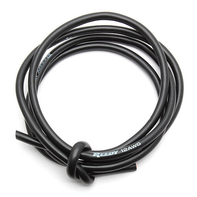

For wire, automotive wire is a good choice or sticking with the RC hobby options designed for high current applications, something like this is a great choice:

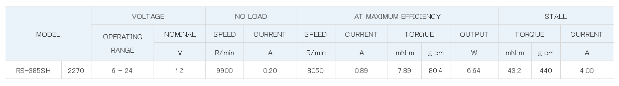

I expect that specs are quite close to these from Mabuchi:
