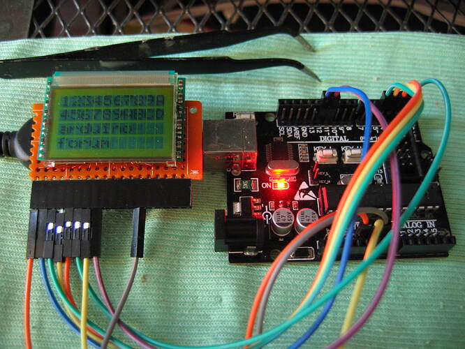

I found a 12x4 LCD module from a Sagem RC712 phone (see pics).
This LCD module has an Samsung S6A0073 and HD66712 chip driver.
I connect this LCD on Arduino UNO as following (similar to LiquidCrystal HelloWorld Library description)
only to check if LCD work?

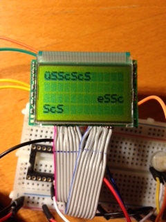

Further, I know the LiquidCrystal Sketch is not for this 12x4 LCD (it shows somehow readable and mysterious characters), but it is possible to drive this LCD correct with amended settings in the sketch?

I have also salvaged the display from this old phone and have been partially successfull to make it work with he Uno and the LiquidCrystal library.
My problem is that the characters are being displayed "one row of pixels ahead", instead of centered on each segment. I'm not knowledge enough to find a solution by reading the datasheet or playing with the LiquidCrystal.cpp file, hence I'm here looking for some guidance.
A photo and the pinout of the LCD can be found here under Sagem RC712:
http://www.module.ro/siemens_lcd.html

Unfortunately that did not have any effect. Also, the display started having the same erratic behavior the OP mentions in the first post, with random characters being displayed more or else randomly after uploading. Ex: 123456789 would show as "#$#/@[]{€ or similar.
