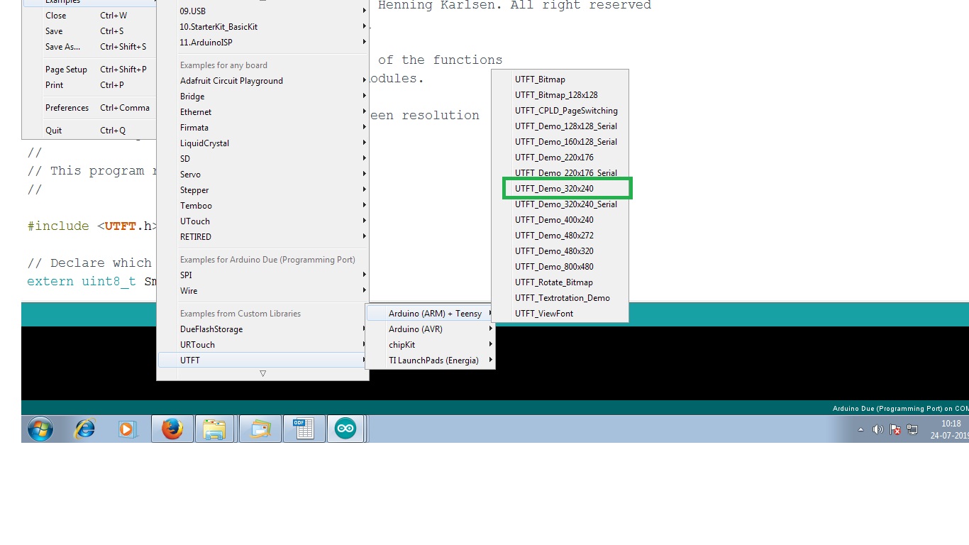

I had tested the UTFT_Demo_320x240 example with Arduino Due+ TFT Shield for Mega+ 3.2"Sainsmart display and found the display is not working. (Display shows the blank Screen)
I had attached the example path image which had taken and the UTFT_Demo_320x240.uno file for your
reference.

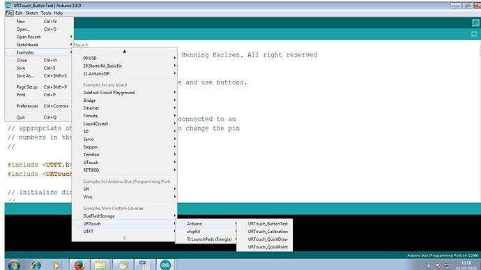

Hi David,
I had download the UTFT v2.8.3 and URTouch v2.0.2 library from rinkydinkelectronics.com.
The library had been added using Tools menu --> Include library --> Add .ZIP library.
The same had been tested and found UTFT library and URTouch library also not working with
Arduino Due + TFT shield for mega + 3.2 inch Sainsmart TFT touchscreen display.
I had attached the example path image which had taken and the UTFT_Demo_320x240.uno and URTouch_ButtonTest file for your reference.
Did i made any mistake? what next?

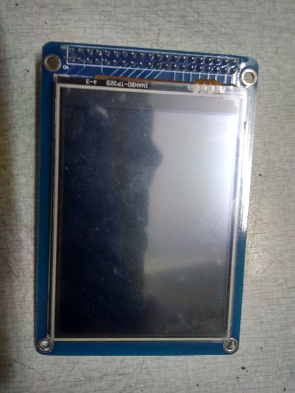

Hi David,
Thanks for the reply.
I had attached the Front side and back side Image of Arduino Due and TFT shield for mega & 3.2"
Sainsmart TFT Touchscreen Display.
Kindly check and also please let me know which partnumber of display you are using?
kinldy post so that i try to buy and test the same.
Regards,
V. Prakash
CTE TFT LCD / SD Card Shield For Arduino DUE Support 32Pin 40Pin Versi
I had ordered this part to interface Arduino Due + cte-tft-lcd-sd-card-shield-for-arduino-due-support-32pin-40pin-version + 3.2" Sainsmart TFT Touchscreen.
Regards,
V. Prakash
Thanks for your photo. Yes, you really do have TFT_320QVT
It should work on MEGA2560.
It should work on Due
I am surprised that you received TFT_320QVT because TFT_320QVT_9341 has been supplied by most shops for several years.
Your Due looks genuine. It should work.
My Due is a clone. Chinese clones work.
If your genuine Due is faulty, run the screen with the MEGA2560.
David.

I have lost the plot. Which message has a photo of your display pcb? What does it say for pin#2 of the 40-pin?
If it says 3.3V you should make JP2, break JP1
If the LEDA pin says 3.3V you should make JP4, break JP3
I suspect that your display needs 5V but only you have the item on your desk.
Note that this DUE shield must only be used with a Due.
David.
Hi David,
My 3.2" Sainsmart display is 3.3V. Kindly refere the attachment.
As my Sainsmart display is 3.3V, I should make JP2, break JP1
If the LEDA pin says 3.3V I should make JP4, break JP3
am i right? Shall i do this to turn ON my Display with Arduino due with Shield PCB?
Please let us know.
Ok
Regards,
V. Prakash
I suspect that your TFT_320QVT requires 5V.
I1 looks like a 3.3V regulator.
J1 looks like it is open.
I don't own a TFT_320QVT
Many readers do own the TFT_320QVT
I am sure that your TFT_320QVT should just plug into the Mega Adapter Shield and work with UTFT on a Mega.
I am sure that your TFT_320QVT should just plug into the Due Adapter Shield and work with UTFT on a Due.
