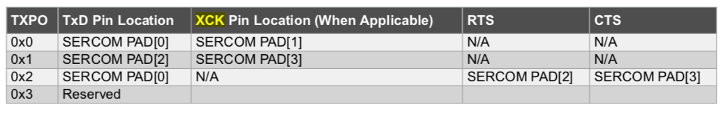

#define PAD_TESTSERIAL_RX (SERCOM_RX_PAD_1)
#define PAD_TESTSERIAL_TX (UART_TX_PAD_0)

From what I can gather from the variant.[h|c] files, sercom4 is supposed to be already in use for SPI. My particular project does not make use of SPI, and I am perfectly fine with disconnecting any conflicting SPI functionality, as long as I can use an UART on those particular pins (that is, pins 15/16). Also, those pines are marked as "analog pins" A1 and A2. Again, I do not use analog pins on this particular project, and I am fine with disconnecting anything that conflicts on those pins.

Why would the above program not work in my setup? Am I missing some step? Are the steps done in the correct order? Do I have to explicitly rip out SPI and/or analog functionality from the target pins in order to initialize the UART?
