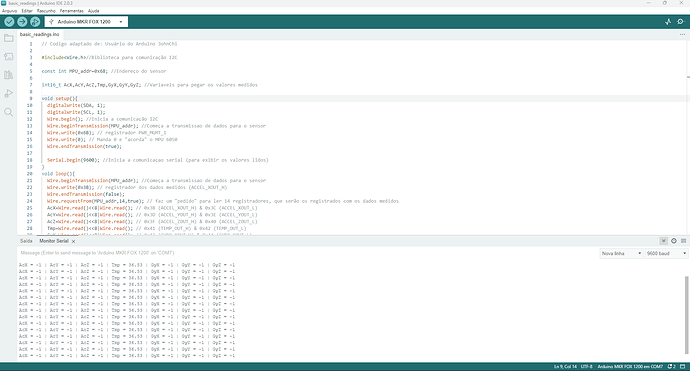

When run my MPU 6050 code, adding the internal pull-up resistors. I get this in the serial monitor:

As i said it shows all the addresses from 1 to 118. Then, when i run the MPU 6050 code acceleration in the axis get stucked in -1, as well as the temperature.

The SAMD21 board is set to be a MKR Fox 1200, just like @horace. I initially set it as a Arduino Zero board using the native port, but my serial monitor was freezed in that setup. When I changed to a MKR Fox I started to see life in the serial.Eventhough it's not useable data .
It looks to me like the MKR FOX1200 has SCL/SDA on PA8/PA9
