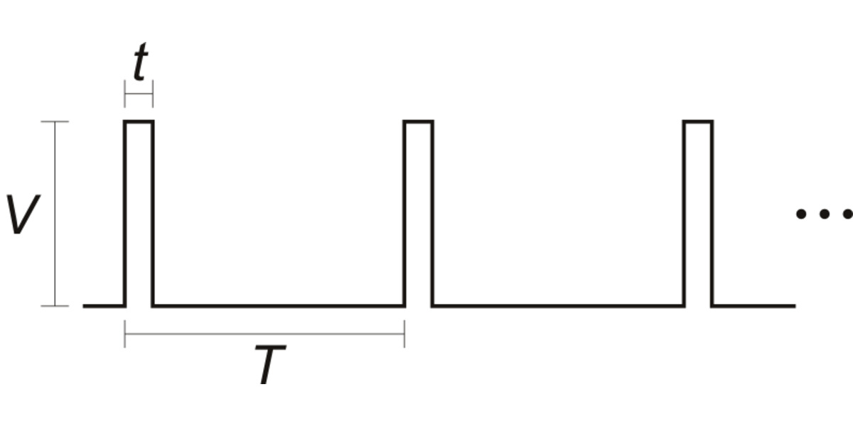

Tap into the servo signal before the servo. The digital inputs on most Arduino compatible processors have more than 10M Ohm input impedance so will not effect (load) the signal at all. If the servo signal is over 5V it will need conditioning. A resistor voltage divider can be used.
There are many tutorials on the net about how to read servo signals with an Arduino. Often using the pulseIn() function.
You just tap into the wire. Doesn't matter where. Do it wherever is most convenient
The inputs of the Arduino are high impedance. This means that connecting them into an existing circuit has practically zero effect on that circuit.

I'd like to record the positions of servos in my model aircraft. The servos are controlled by a separate device, which issues PWM signals to the servos independently of my Arduino. The PWM signals must be monitored in real-time to reflect control surface changes that happen infrequently but asynchronously. Those changes must then be recorded, along with time stamps to allow flight reconstruction.
I hope you see where I'm going with this. The PWM signals are nothing like those potentiometers in your example code. Instead, they are pulse widths, which your Arduino code must measure and store for comparison from code cycle to code cycle, watching for changes that may represent control changes(or may represent insignificant signal width variations), and writing to storage all changes deemed significant, along with a time stamp for each. Not a trivial task, though not insurmountable.

The easiest way to tap into the signal to the servos is to use a “Y” connector. These are used to connect two servos to one receiver output. You will only need to use the ground and signal wires. In fact you will only need one ground wire from the receiver. You will need one for each servo.
You will have to limit the peak input voltage as mentioned above. The need for this will depend on the voltage your receiver is operating at. For example, a receiver on an electric plane using 5 volt power from a BEC or the ESC, assuming you are using 5 volts to power the Arduino. A resistive voltage divider or other voltage reducer such as a diode or zener diode and resistor will have to be used for higher voltages. If you have an oscilloscope or volt meter that can read peak voltage you could measure the actual peak voltage output of the receiver to determine if you will need attenuation or not.

As I described earlier, measure the pulse width of each of the four signals and record those if they change beyond a predetermined deadband. Do that round-robin, saving each change to SD, along with a millis() timestamp, if it's warranted. You must determine what is a significant change, and how frequently to measure and save.
Not optimal with an Uno, as your pulse width measurement will be 4uS increments, iirc if you use micros(), not sure what can be done if you use a hardware timer, but it's a start.
