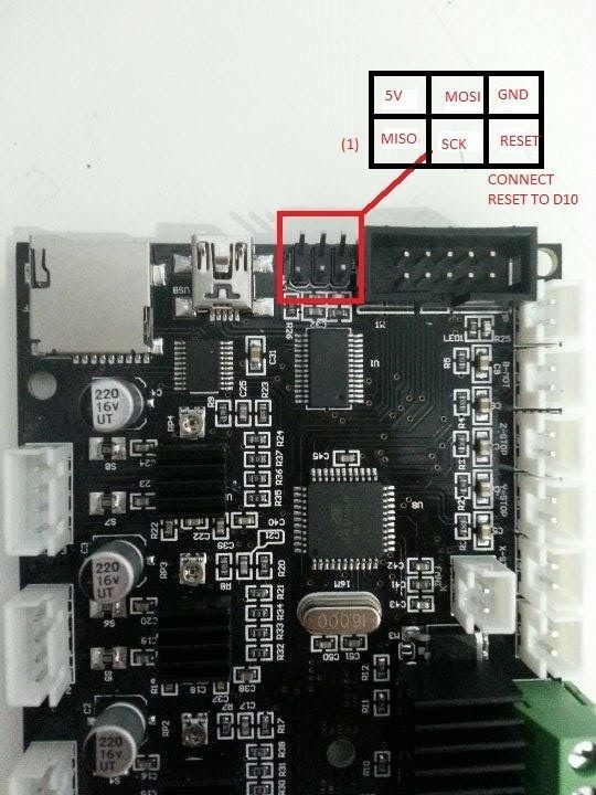

So im trying to install a bootloader on an ender 3 printer.
what i need to do is this.
  1. use ex sketch arduino isp
  2. add u8glib library
  3. add sanguino board
  4. hook up the arduino
  5. select uno as the board(Im confused as to why i had to upload the sanguino board, but then select the uno board. Ive checked 3 places and these are the proper instructions) and select the com port the board is on
  6. upload sketch

Step 2 is strange; you do not need that library to upload a boot loader. It's only for sketches.
So I would (assuming the sanguino is the target)
a)
Use the Arduino ISP sketch and upload it to the Uno
b)
step 3
c)
connect Uno and Sanguino via ICSP
d)
select ArduinoISP under tools -> programmer
e)
select sanguino under tools -> board
f)
connect the Uno to the PC
g)
select the Uno port under tools -> port
h)
select tools -> burn boot loader
Note
If you want to upload a sketch via ICSP, only step (g) changes; use sketch -> upload using programmer. You will probably need the library for that.
In future, please provide links to the instructions that you found. That way we can check what the intention is.

Sorry what is ICSP? Do you think you could give me a link about how to do this? I just happened to have bought an arduino 12 years ago and used it once or twice and just had it when i seen i needed it to install the firmware.
Ive checked several different sites and they all use the same steps

boxeddroid:
https://m.all3dp.com/2/ender-3-with-marlin-how-to-install-marlin-firmware-on-your-ender-3/
boxeddroid:
Because you're using an Arduino Uno as an "Arduino as ISP" programmer to upload the firmware to your 3D printer board. You're uploading the ArduinoISP sketch to the Uno, not to the 3D printer, so you need to select Uno when uploading to the Uno.
When you get to the step where you're using the Uno to upload to the 3D printer, then you will select the Sanguino board.
boxeddroid:
OK, so now we're talking firmware which is not the same as boot loader; see my first note.
Some links:
https://www.arduino.cc/en/tutorial/arduinoISP
On the page that you linked is an image (https://i.all3dp.com/cdn-cgi/image/fit=scale-down,w=686,gravity=0.5x0.5,format=auto/wp-content/uploads/2019/02/08142633/this-diagram-shows-pin-outputs-instructables-190121_download3.jpg, not my image so not showing it here) that shows the ICSP header with pin descriptions.
